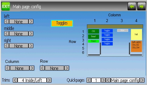

07 Jun 2013 07:46 - 07 Jun 2013 08:31 #10672 by Pattaya01
What do you think of this (Done with Paint, so it looks messy):
The small screen on the right represents the end result. Pressing an element in the small screen give me options: Edit or delete. ( And a button "Add", they should be under the small screen)
When I press edit, it jumps to the left where I can edit, change and (re)position it using the column and row buttons. If an element is to big for the space selected, a warning pops up. When done you press a button called "enter" (not there, could be on the right of column and row selections)
Just an idea.
Last edit: 07 Jun 2013 08:31 by Pattaya01.

07 Jun 2013 09:37 #10675 by rbe2012
Well... that is quite similar to my ideas.
But I have designed the preview screen to be as big as possible to make it easy to touch the element you want. If we reduce the size it will get harder (esp. on Devo8).
This is why I have invented these little action buttons at the top of the column - I have simply no other space for it.
How to do the switching between (1) moving through the elements in the preview, (2) changing element properties and (3) selecting an action for an element is the point where we stand actually.
It would be quite easy if we only have the touch pen to work in the gui. You can touch every screen element you want and an appropriate reaction will follow. It is very easy to recognize if an element is touched, an action button or a property field.
But when you want to make it usable with the 6 keys on the tx only you are much more restricted. You can only move from one screen element to the previous or next and have a limited number of actions. It might need many key presses to move to a special position.
Possible would be something like this:
  1. normally you walk through the elements in the preview with up and down
  2. if you hit "enter", the element gets selected and the control elements (action buttons and property fields) appear
  3. from this moment you can do anything you want with the selected element like moving it or changing type or source
  4. to go back into the preview you have to hit "exit"
  5. hitting "exit" in the preview lets you save or cancel the changes
Using the touch pen this would be similar (most like it works actually):
  1. normally you select an element in the preview by touching it
  2. the element is automatically selected and the control elements (action buttons and property fields) appear
  3. you can do anything you want with the selected element like moving it or changing type or source
  4. to go back into the preview you simply select another element
  5. saving or canceling the changes is possible at every time
I think this will be the direction I go next. I have to write down my thoughts to sort them out. The above looks reasonable and might result in a gui which can be controlled via touch pad and keys with similar convenience.

07 Jun 2013 11:48 #10678 by FDR
Sorry if I'm joining too late, but I've got some thoughts on the matter:
The first is a cosmetic one: I would place the preview on the left, and the boxes of the property values on the right. While it doesn't really matter if you use the pencil, it makes much more intuitive if you tab throw the controls with the keyboard.
Secondly, I would supplement your algorythm of editing with the keyboard in the following points:
2. when you hit ENT the property fields appear and the focus jumps to the first of them.
5. I wouldn't require the OK/Cancel at every element. Instead I would enable the long ENT to save and the long EXT to cancel (if you want to do it in place, just like on the mixer pages), or let the user to navigate to the OK/Cancel buttons in the end...

07 Jun 2013 13:07 #10679 by rbe2012
FDR, here we say: better too late than never... welcome.
Placing the preview on the right will be possible; I will give it a try.
2: good idea
5: I think I did not say clearly what I thought:
We need a way to leave editing the properties and go back to selecting another element. This is what I described at 4.
We also need a way to leave the main config page. Actually it works this way: if nothing has been changed, the usual exit, left and right buttons in the headline are present and working. If something is changed, they are substituted by two buttons "save" and "cancel" (they do what they are labeled to - and they show again exit/left/right).
It is a good idea to use long-enter and long-exit for navigating but first I will look which keys are necessary for moving between the property fields and their values. But I will keep this in mind.
