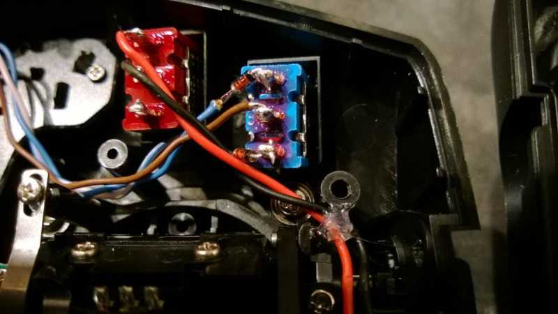

28 Jan 2014 23:21 #19350 by dianjing
thank you for your fireware
i have used it in my 7e.
but now have a question.
sometimes the trim will move automatic.
can you help me to solve this problem.
thanks a lot.

29 Jan 2014 13:02 #19371 by cmpang
dianjing wrote: thank you for your fireware
thanks a lot.
diode leakage.. replace diodes in the switch mod..

29 Jan 2014 13:45 #19373 by rbe2012
...or reverted (there is usually a black line at one end, but I am not sure if it should point to the switch or away from it - see galee's pictures).
29 Jan 2014 15:12 #19383 by robca
rbe2012 wrote: ...or reverted (there is usually a black line at one end, but I am not sure if it should point to the switch or away from it - see galee's pictures).
the black line points towards the switch terminals, both of them
see the enclosed picture I took of my mod

02 Feb 2014 06:04 #19675 by PhracturedBlue
Replied by PhracturedBlue on topic 7e +telem +layout ed +perm timer, weekly updates
dianjing wrote: sometimes the trim will move automatic.
You may need to replace the diodes. If it only happens sometimes, you may have a leaky diode.
