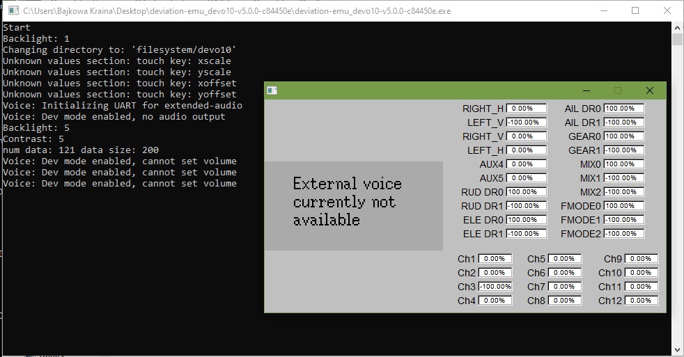

I saw that Wiki for emulator but not to much direct info there. Do what was written there and still no sound
only beeps working, completly no voice or mp3 playing. I'm under Windows 10... maybe that's some problem. Or I have to connect DFPlayer to mic output in PC or some com port? I tought it will play directly by sound card but I got only beeps
Same setup in Devo 10 and all works correctly, but for testing emulator is much more easy.
I check that voicepack tool later, not sure what I need to run it and how.
I found previous voice alert wiki - and there is mpg123.exe file which should play mp3 but it won't work somehow. Not sure what is wrong with my setup
MP3 folder is where exe file is
Hardware.ini - set for dfplayer
Voice.ini in media folder
and still nothing, no voice or even voice menu in emulator.

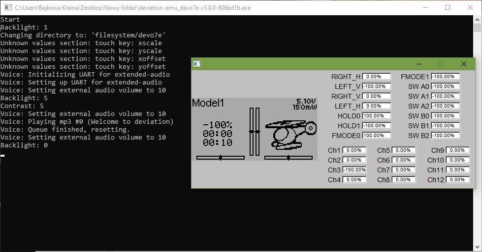

OK, I set Devo7E emulator instead Devo10 and voice works correctly. So I think something is wrong with configuration somewhere. Compare messages in background to Devo10emu... DEV mod enabled - cannot set volume - I think something is set not right in Devo10 emulator

Only voice working emulator is here:
deviationtx.com/forum/builds/5089-voice-...uild?start=800#65442
I suppose there is some Development mode or something turned on in emulators on Download page so they actually doesn't work with audio enabled. So It's almost impossible to test anything on PC, which is much more easy than... make some corrections in ini and send it to Devo to test and again and again...
