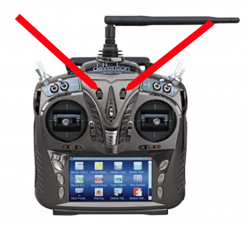

Going on on my check list proposal, may be it could be possible to use one of the two buttons named TRIM_L and TRIM_R for which I have never seen any use (or I have never understood how to assign them to a function :blush: )
Edit : Ok, bad idea :( But the check list would be interesting
Last edit: 29 Mar 2017 18:31 by Morlacus.
29 Mar 2017 09:30 #60897 by pulpfiction15
@Morlacus, i find those trim switches very useful, to fine tune gains during flight. ;)
29 Mar 2017 09:43 - 29 Mar 2017 09:45 #60898 by Morlacus
pulpfiction15 wrote: @Morlacus, i find those trim switches very useful, to fine tune gains during flight. ;)
I too but I was speaking of these 2 buttons shown by the arrows on the file attached. If you use those tell me how you do.
Last edit: 29 Mar 2017 09:45 by Morlacus.

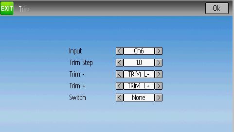

29 Mar 2017 10:52 #60899 by pulpfiction15
@Moriacus,
In the trim menu, I add an entry like this for the left trim switch;
29 Mar 2017 11:21 - 29 Mar 2017 11:40 #60901 by Morlacus
pulpfiction15 wrote: @Moriacus,
Ok Thanks.

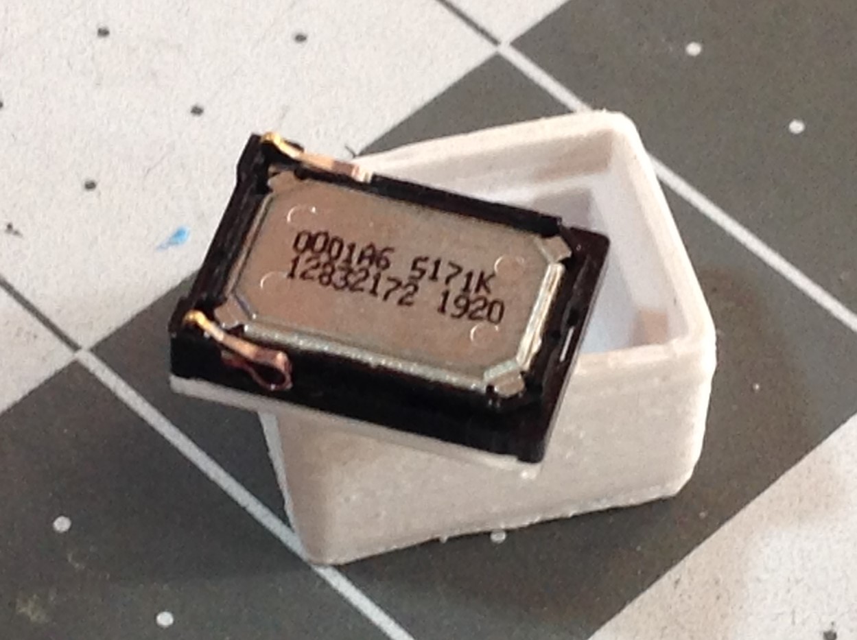

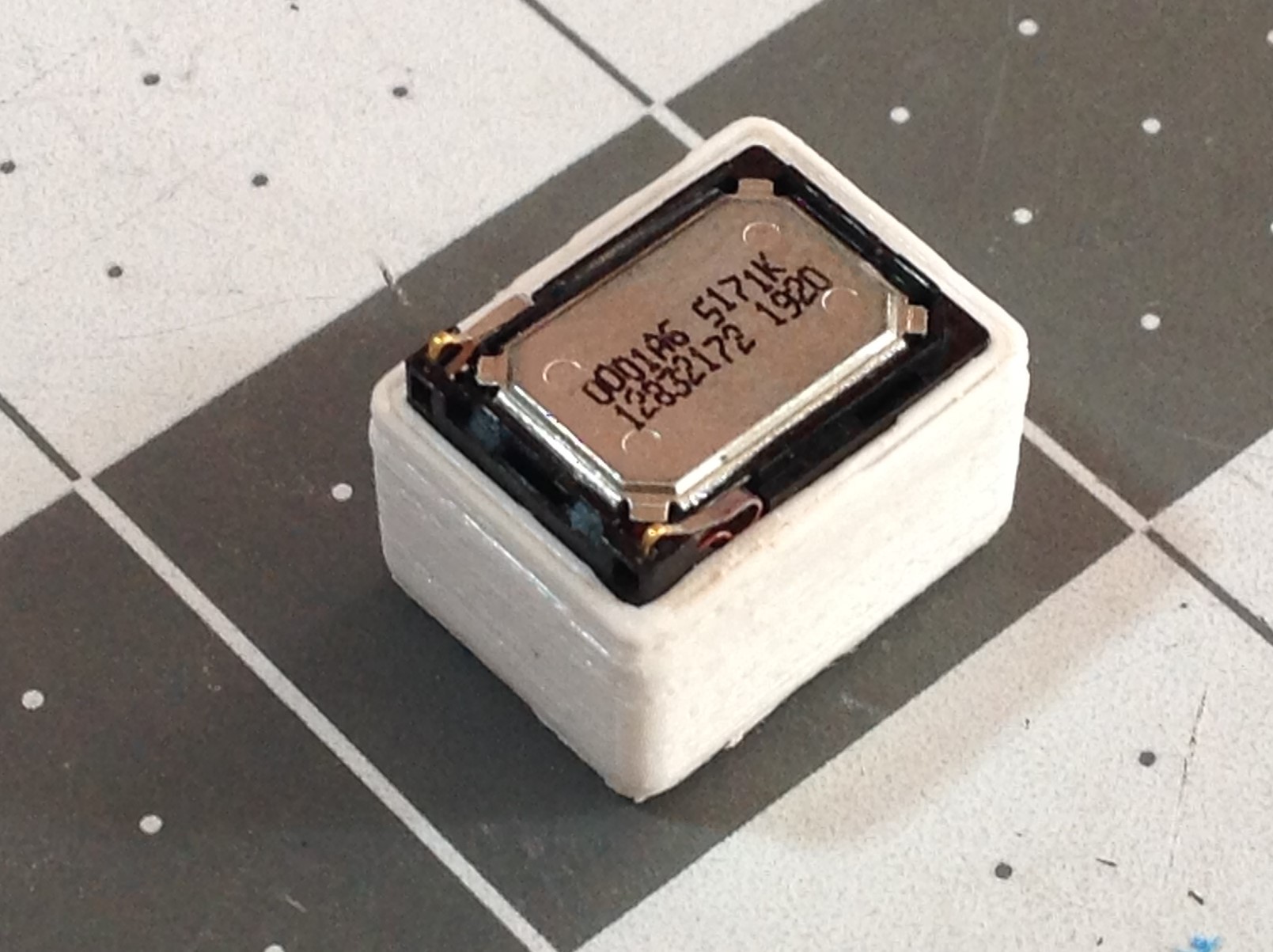

I'm assembling an internal player for my Devo 12e and now have a micro speaker with really big sound. Some time ago I picked up a 15mm x 11mm micro speaker (Knowles 2403-260-00001 available at Digikey) but it isn't very loud without a sound enclosure. Since I have a bit of room in the 12e, I designed a 3D-printed enclosure box that the speaker snaps into. The sound is definitely as big as the 29mm speakers I have tried, and should be easier to place in the shell. It costs almost nothing to print.
I've posted the design to Thingiverse item 2220544 .
