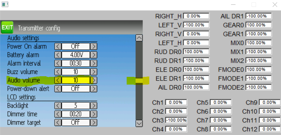

08 Apr 2022 12:12 #77943 by -=Hubi-Dirk=-
Replied by -=Hubi-Dirk=- on topic Voice alerts test build
I have no Devo 8s here to try it out but i have a look at the Devo 8 emulator nightly version 2021-06-06.
There is a setting for audio volume, the sidebar should be half the way in the middle.
17 Apr 2022 13:48 #77944 by leventuygun
Replied by leventuygun on topic Voice alerts test build
BlackLotus wrote: Try with Nightly build. I'm also using Devo 8.
Dear BlackLotus, I tried all the nightly firmwares for devo8. But nothing changed, non of the nightly's have volume control tab in the tx config page.
I thing there is something wrong in .DFU files. May be, if your firmware is working you can share. :)

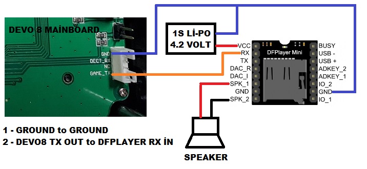

08 May 2022 19:44 #77969 by leventuygun
Hi everybody,
After a while some work with devo8 for voice modification but no success again.
1- Df player is working and play files in the MP3 folder by itself when triggered with button.
2- in SD card there is a mp3 folder and there is voice pack inside the mp3 folder.
3- "voice.ini" inside the media folder.
4- "hardware.ini" modified as descripted.(from BLACKLOTUS)
5- Old Dfu file changed with "deviation-devo8-v5.0.0-c84450e.dfu"(from BLACKLOTUS)
By the way there is no "sound volume setting" in the tx configuration page again,like old one.
Tried when buzzer volume;(step by step) off position to "10" nothing changed.
"PPM in" tried on all positions nothing changed.
6- I'm giving power the dfplayer before powering the tx against any delay.
** wiring digram attached
09 May 2022 03:38 - 09 May 2022 03:39 #77970 by BlackLotus
Replied by BlackLotus on topic Voice alerts test build
I think maybe you still miss some setting.
I can't remember setting cause I've done this long ago.
DFPlayer with only RX connection is one directional, not bidirectional.
so I think missing volume control is caused by wrong software setup.
(But still I'm not sure :( )
check your firmware version in TX "ABOUT" menu.
backup models and clean up memory and replace with firmware stock files.
and I'll upload photo of what I wired DFPlayer and DSC jack to board.
Newbie who using Devo 10
Last edit: 09 May 2022 03:39 by BlackLotus.
10 May 2022 04:31 #77972 by hexfet
Replied by hexfet on topic Voice alerts test build
The "Audio Volume" setting should appear in the transmitter config page for Devo8 regardless of whether a voice module is installed. Try installing the devo8 firmware at this link .
19 May 2022 06:29 #77990 by leventuygun
hexfet wrote: The "Audio Volume" setting should appear in the transmitter config page for Devo8 regardless of whether a voice module is installed. Try installing the devo8 firmware at this link .
Hi again, I cleaned everything in memory of my Devo8, then update the Nightly Firmware again.
( www.deviationtx.com/downloads-new/catego...8-v5-0-0-f6f940d-zip )
This firmware has a black background and there is no Audio Volume setting and (not important but) in the menus the letters does not appear.
After even modified ".ini" files, there is nothing changed. :)
