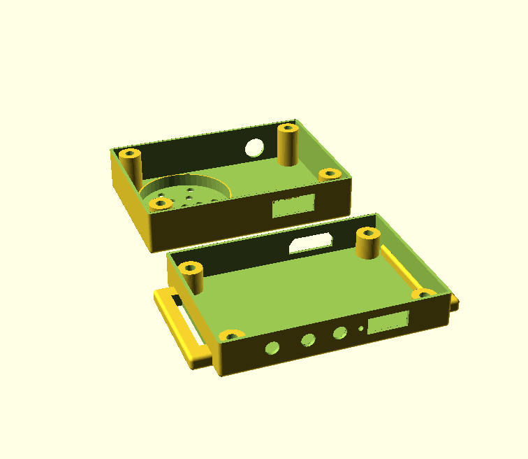

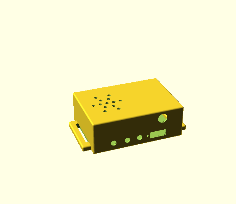

I'm almost finished with the external box for the DFPlayer. It's set up for a common 60mm x 40mm (56mm x 36mm mounting hole centers) PCB on which I've mounted the DFPlayer, power regulator, switches and LED along with a USB port. The handles allow you to strap it to your TX or whatever. I'm sending the STL out to get a couple printed up, then if everything fits right I'll post a blog entry somewhere. Here is the basic look.
Last edit: 05 Mar 2017 02:04 by Deal57. Reason: Clean up graphics
