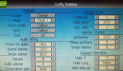

23 Mar 2017 09:22 - 23 Mar 2017 09:25 #60590 by Morlacus
No way to have any sound on my devo 12s. All works well but no sound....:( Any idea ?
A remark about presentation.on the TX config screen. The titles and underlining are not correctly displayed (Same for devo 8s)
Last edit: 23 Mar 2017 09:25 by Morlacus.

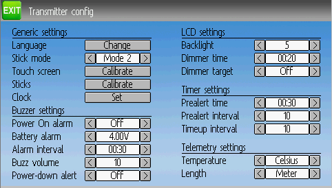

23 Mar 2017 09:40 - 23 Mar 2017 09:45 #60591 by FDR
There might be some inconsistences between the test build and the config.ini, because it should look like this:
I guess your config.ini is out of date...
EDIT: I've just tried, that the underline option indeed doesn't work well when the section label is center aligned...
Last edit: 23 Mar 2017 09:45 by FDR.
