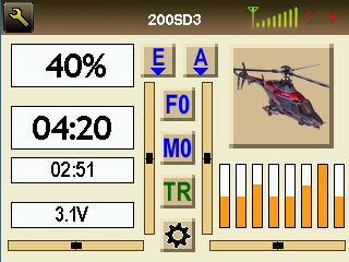

OK, got first revision of my custom skin all done. Here are some screen shots. This was created for the Devo 8s. The model icon is a picture I took of my Walkera 200SD3 (which has a 200SD5 fuselage on it... I preferred the 200SD5's color scheme better)
Splash Screen
Main Page (Low Dual Rates, Flight mode, Mix Switch, Throttle Hold not Enabled, Gear Up)
Main Page (High Dual Rates, Mid Flight mode/Mix Switch, Throttle Hold Enabled, Gear Down)
Main Page (Reduced Tx Powers are Amber)
Main Page (Lowest 2 Tx Powers are Red) (I wished I could click in the Tx Power icon to go to the Model Menu to change the Tx Power. It would be a nice added feature.)
Main Page (Trim colors are green - Right / Down, Red - Left / Up)

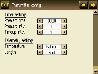

Tx Config Page

It looks nice. Thanks for doing a full theme.
Did you find anything you wanted to be able to customize (themewise) and couldn't?
I'll have to think about the graph-line thickness, I'm not sure how easily that can be done. But any colors you wanted to change that were fixed (besides the USB screen)?
02 Dec 2013 15:27 - 02 Dec 2013 18:08 #16186 by WheresWaldo
Replied by WheresWaldo on topic New color skin
Very cool looking.
Is there a way to tint the dialog box?

For me it's nice too. To be complete: can you produce the background in 480x272 (devo12.bmp) and splash screens for Devo6 and Devo12?
@PB: When I looked at henkerhaus' work I have seen that he has embossed his icon what looks better for me than a flat icon. This can be done with the icon, but could also done by the gui.
It might be an interesting feature to create an image used as a frame and place the icon (with transparency) on top. I think about an image which defines the corners and only a small part of the sides which is replicated as often as needed (to save space and to allow different icon sizes. This way we could easily change the frames for all icons at once.
Something like this (height=frame width, corners upper left, ur, ll, lr, border top, l, b, r):

I like to blend the icon into the background more.
If there is a frame it looks ugly when not aligned with the other controls, and it is difficult to always achieve perfect aligning...
EDIT: ...especially if there are different icon sizes...

The only other things that stood out for me was I would have liked to be able to specify the outline_color of the scrollbar fg_color as black for higher contrast of the position indicator. Similarily, I would have liked to be able to specify the outline_color of the trim fg_color_pos and fg_color_neg as black also for higher contrast of the position indicator. A centerline on the trim indicators in the outline_color would be nice too. As I mentioned earlier, the color of the URL reference on the Version screen needed to be black instead of white, but if that was Black by default, I wouldn't ever need to change it.

henkerhaus wrote: The only other things that stood out for me was I would have liked to be able to specify the outline_color of the scrollbar fg_color as black for higher contrast of the position indicator. Similarily, I would have liked to be able to specify the outline_color of the trim fg_color_pos and fg_color_neg as black also for higher contrast of the position indicator. A centerline on the trim indicators in the outline_color would be nice too. As I mentioned earlier, the color of the URL reference on the Version screen needed to be black instead of white, but if that was Black by default, I wouldn't ever need to change it.
Centerlines are already in the code:
You also can create an outline for the trim position, though it requires a code change. the original code looked like this:
but I didn't find it had enough contrast when the bar was blue/red so I disabled that part, though the code is still present.

The bottom screen trims are exactly what I'd want, but I'd make the Outlines Black. Can i "turn these on" by adding some color definition lines to the config.ini file? Or does it require a different DFU binary? (Not to nit pick too much, but it would look better if the Left vertical trim outline was a mirror of the Right, instead of a duplicate. But I know, it's easier to program it as a duplicate. Perhaps if the short segments were all centered, then it wouldn't matter :)

henkerhaus wrote: The bottom screen trims are exactly what I'd want, but I'd make the Outlines Black. Can i "turn these on" by adding some color definition lines to the config.ini file? Or does it require a different DFU binary? (Not to nit pick too much, but it would look better if the Left vertical trim outline was a mirror of the Right, instead of a duplicate. But I know, it's easier to program it as a duplicate. Perhaps if the short segments were all centered, then it wouldn't matter :)
No, you can't turn them on without building a new DFU. Maybe there's something I can do though. the reason the hash marks are on one side is that the bar is one pixel smaller, so you can (just) still see them when the position box overlaps. In practice I'm skeptical this is visiblee on the Tx.
They went through a few rounds of different implementations. I don't know if they tried drawing the hash marks after the cursor (in which case you could center them)

Work. Diff:
diff -r 40441afc2802 src/gui/320x240x16/_bargraph.c
--- a/src/gui/320x240x16/_bargraph.c	Mon Dec 02 20:04:21 2013 -0800
+++ b/src/gui/320x240x16/_bargraph.c	Tue Dec 03 16:45:59 2013 +0100
@@ -40,17 +40,17 @@
         LCD_FillRect(x, y, width, height, disp->bg_color);
-    //Bar trim points
-    int hmap[] = {height / 2, 3 * height / 4, height / 2, height, height / 2, 3 * height / 4, height / 2};
-    for (int i = 0; i < 7; i++) {
-        LCD_DrawFastVLine(x + (i + 1) * width / 8, y, hmap[i], disp->outline_color);
     // Main rectangle
     if (TRIM_THICKNESS) {
         LCD_FillRect(xpos - (TRIM_THICKNESS / 2)-1,
                      y + TRIM_MARGIN,
                      TRIM_THICKNESS, height - TRIM_MARGIN * 2, color);
+    //Bar trim points
+    int hmap[] = {height / 2, 3 * height / 4, height / 2, height, height / 2, 3 * height / 4, height / 2};
+    for (int i = 0; i < 7; i++) {
+        LCD_DrawFastVLine(x + (i + 1) * width / 8, y + (height - hmap[i]) / 2, hmap[i], disp->outline_color);
     // Marking rectangle
     if (TRIM_INNER_THICKNESS) {
         LCD_FillRect(xpos - (TRIM_INNER_THICKNESS / 2)-1,
@@ -69,17 +69,17 @@
-    //Bar trim points
-    int wmap[] = {width / 2, 3 * width / 4, width / 2, width, width / 2, 3 * width / 4, width / 2};
-        LCD_DrawFastHLine(x, y + (i + 1) * height / 8, wmap[i], disp->outline_color);
     // Main rectangle
         LCD_FillRect(x + TRIM_MARGIN,
                      y + (height - val) - (TRIM_THICKNESS / 2) - 1,
                      width - TRIM_MARGIN * 2, TRIM_THICKNESS, color);
+    //Bar trim points
+    int wmap[] = {width / 2, 3 * width / 4, width / 2, width, width / 2, 3 * width / 4, width / 2};
+        LCD_DrawFastHLine(x + (width - wmap[i]) / 2, y + (i + 1) * height / 8, wmap[i], disp->outline_color);
     LCD_FillRect(x + TRIM_MARGIN * 2,
In the emulator it is sufficient good visible. I have not tested on an tx.

It works and I think it is better, but probably negates the ability to put a border around the trim position cursor.
I'm open to suggestions.

Yes, I agree it looks better centered. Very nice.
With the trims centered, and the trim position indicator being black, the outline on the trim position indicator isn't useful, but my thought was that when the trim indicators ARE off center, and the colors are not black, a dark contrasting border color would improve visibility of the indicator edges.
