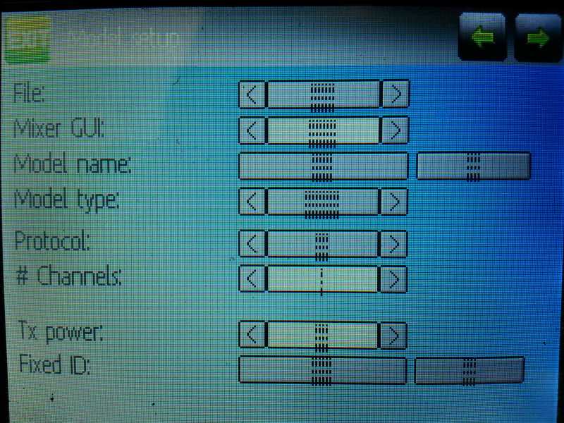

28 Jun 2013 16:04 #11518 by Spyro37
Replied by Spyro37 on topic How to upgrade Devo TX to Deviation Firmware
I just updated my 8S deviation V2.1.1 to V3.0.0
My screen's numerical value now appears like this on this picture from page to page.
What am I doing wrong?

28 Jun 2013 17:34 #11523 by rbe2012
Replied by rbe2012 on topic How to upgrade Devo TX to Deviation Firmware
Have you put the filesystem on your tx? It looks like missing fonts. You should save your models, overwrite the filesystem, restore your models and calibrate touch screen and sticks to complete the upgrade process.
28 Jun 2013 19:43 #11528 by Spyro37
I first saved my models in my PC. Then, deleted the the old FS from the previous version.
Upgrade to v3.0.0 then drag and dropped the new FS. I tried doing it several times and ends up the same screen appearance. I also tried to restore my 2 models, and still looks the same.
Everytime I go back the previous FW version, everything is OK.
I'm pretty lost...

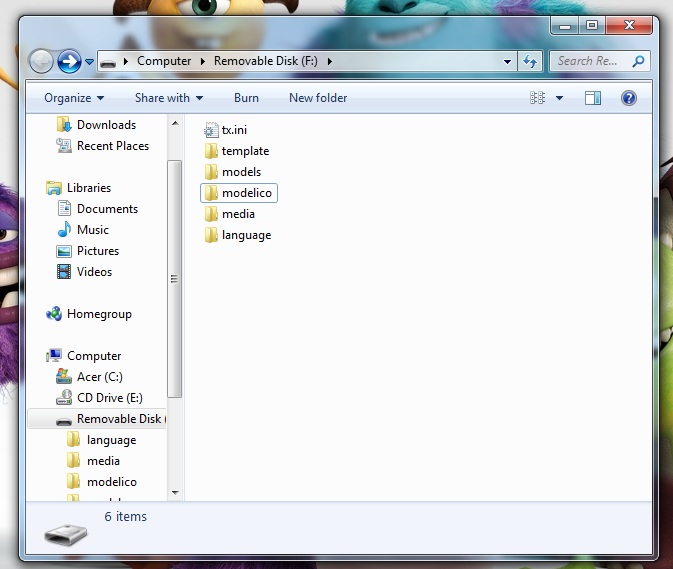

28 Jun 2013 20:03 #11529 by rbe2012
Do you have a structure like this in your file system?
├───media
├───modelico
├───template
├───models
├───language
├───layout
└───tx.ini
You should not have a directory "filesystem" nor "devo8", only those mentioned.
Can you confirm this?
I break my brain but I don't remember what I had to do when I had the same some months ago. I was pretty sure the file system was incorrect, but you updated from a working deviation so there should be no real difference (ok, directory layout is new...).
28 Jun 2013 20:18 - 28 Jun 2013 20:25 #11530 by Spyro37
Here's what I have on my transmitter now.
Removable Disk F is my transmitter.
Files from v3.0.0 download section (deviation-fs-devo8-v3.0.0.zip)

29 Jun 2013 08:02 #11550 by rbe2012
You don't need the emu file - it contains the emulator for running on a pc.
If you have correctly installed the 8a4a0b-version you should at least see a new directory "layout" on the usb device - if not something has gone wrong.
You should have used these: Devo8-dfu from 28-6 and the corresponding fs: Devo8-filesystem from 28-6 . It is important that you use the corresponding fs to the dfu-file, not the one from official 3.0.0 release.

30 Jun 2013 18:16 #11646 by rbe2012
You are right - I did not try it myself until now. I just have taken the link targets of the download page to point directly to the wanted files.
It will be different today because the nightlies have changed.
Please ignore the links I have posted above and choose carefully the correct files from the nightly download page (deviation-devo8-v3.0.0-XXXXXX.zip and deviation-fs-devo8-v3.0.0-XXXXXX.zip).
Sorry for the confusion.
