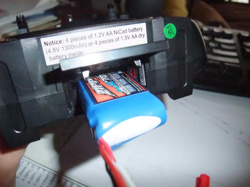

First, it is not strictly related to Deviation, but I thought the Devo7e users would be interested:
I found the battery that fits in the narrow battery compartment and is close by voltage. It is LiFePo4 battery, 700mAh, 2S, 6.6V, with much less self discharge compared to NiMh, NiCd batteries. I know it less than typical NiMh, but in the long run it is better, because it is ready every time you need it, due to low self discharge current:
www.hobbyking.com/hobbyking/store/uh_vie....asp?idProduct=14075

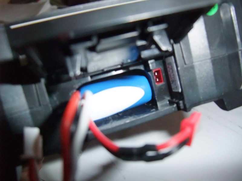

Now the Tx is even lighter and battery seems to last forever. What needs to be done is: file down the plastic tabs that act as sliders for battery holder, change the connector to JST, change the alarm voltage to 6V.

so alarm set to 6V should work OK. I am using this battery over a week now, no issues (some users report problems with LiPo 2S 7.4V being to high and problems with saving during shut down).

I own a Devo6. And after watching the photos in this topic, it seems very similar to what I have on my Devo6. I think the Devo6, and maybe the Devo8 or other model could be modded the same way, if they need the same power supply.
