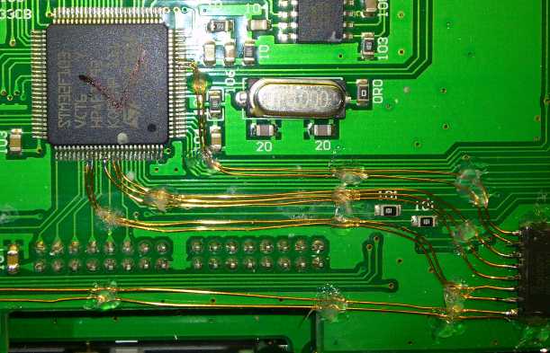

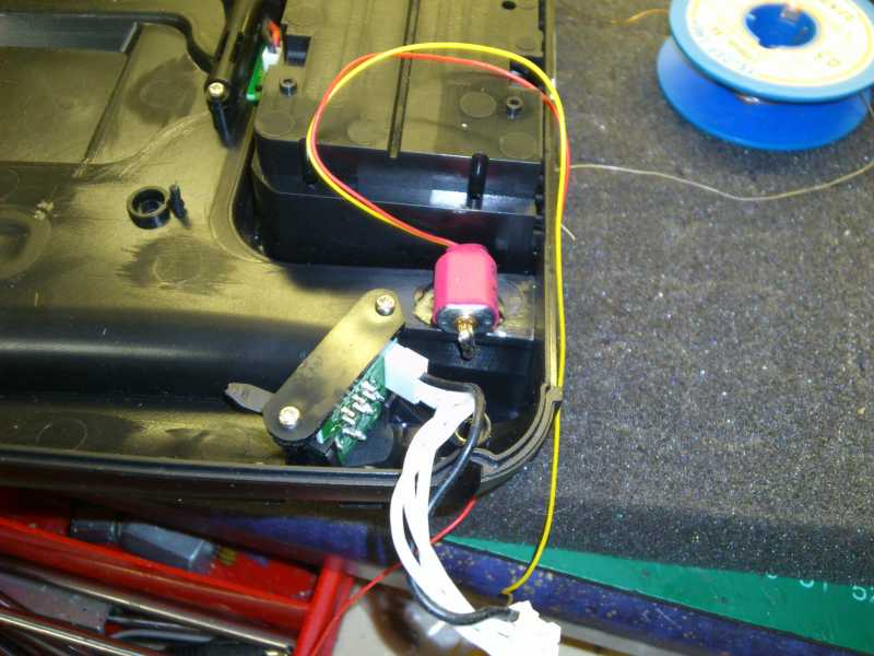

Playing around with the code and the hardware I got the idea to add a vibration motor to my Devo8. The sound is sometimes not loud enough. And the Devo10/7E already have one so I thought the code could easily work for Devo8 also.

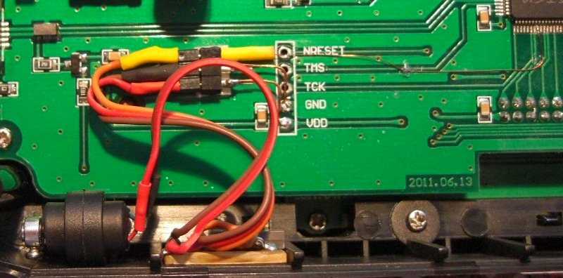

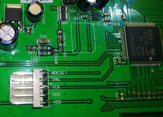

Looking at the hardware connections of Devo10 (in the "Articles" section) told me that pin PD2 is used as output. Devo8 does not make use of this pin and I have found nothing connected to it on the board. So I decided to give it a try.
First I wanted to use a simple driver-ic (uln2003) to avoid damage to the mcu when I do something silly. This ic has 7 lines so why not using it for more than PD2? So I looked for some more free gpio pins and found a lot, selecting 7 of them.

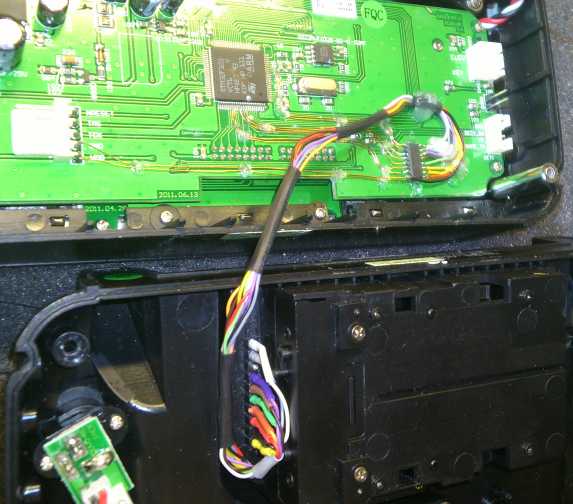

Soldering wires to the pins was quite difficult because they are very small (about 0,25mm wide) and there is not many space between them. But with good equipment and a stable hand I got it.

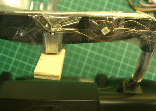

The driver ic gives enough power for a tiny motor. I looked for a little one in my boxes and found a servo where the electronic was dead. The motor seemed to be ideal - small, not much current, working with less than 5V... Cutting a peace of wood, drilling a hole far outside the center and placing it at the motor axis was easy. I simply fastened it with tape at the handhold and tried it directy with the battery - works good, sufficient vibrations to feel them good. Later I will build another weight (surely metal) and place it inside the tx but for now it is good.

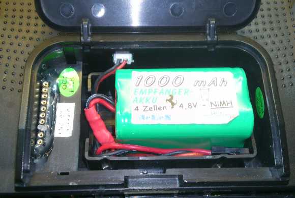

Then I soldered the wires correctly (placed a plug in the battery case because I did not want to drill visible holes in the tx case only for testing) - one wire to the output of the driver, the other to VDD (got VDD and GND from an additional header I soldered in the free holes on the left side).
The changes I had to make in the software were really easy: I only had to set the value for "#define HAS_VIBRATING_MOTOR 0" to "1" in target/devo8/target_defs.h. Then opening the tx.ini-file and setting "vibration=1" and I was done!
I have written some easy code to be able to switch vibration off and on without onpening the tx.ini file. I can post it if anybody needs it.
It should work in a similar way in Devo12 but the PD2-pin is used there. So some changes in the code have to be made, but nothing difficult.

Replied by rbe2012 on topic Devo 8: adding a vibration motor
On the second picture you can see the MCU left (labeled STM32F103) and the driver ic on the right (uln2003).
The MCU can drive some load (I have looked into the data sheet but I could not find anything about this so I assume the power is quite low). So you will have to place an driver ic or an transistor as amplifier in between - if not you risk to burn the MCU...
I have tested a vibrating motor from a LG phone but the vibrations were too small (the tx is relatively heavy compared to a cell phone) and it was not really remarkable. So I took a motor from a burned servo and soldered some weight to the brass gear.

I have a small vibrating motor that's on my Hobbyking 720P wingcam that doesn't need to be there so I might use it.
What would you use the other connections for that you soldered to the driver-ic?
04 Apr 2013 11:32 #8506
The driver ic I used has 7 in-/outputs so I looked for unused gpio-pins at the MCU in case of needing them later (maybe for switching between different rf-modules or whatever). The pin I used for the vibrating motor is the same as in the Devo7e/10 so the changes to the software were minimized.
Soldering was really not easy, but when I knew how to solder the first wire the rest was much easier (using a magnifier an a really spiky solder tip and being economical with the solder made it possible).
