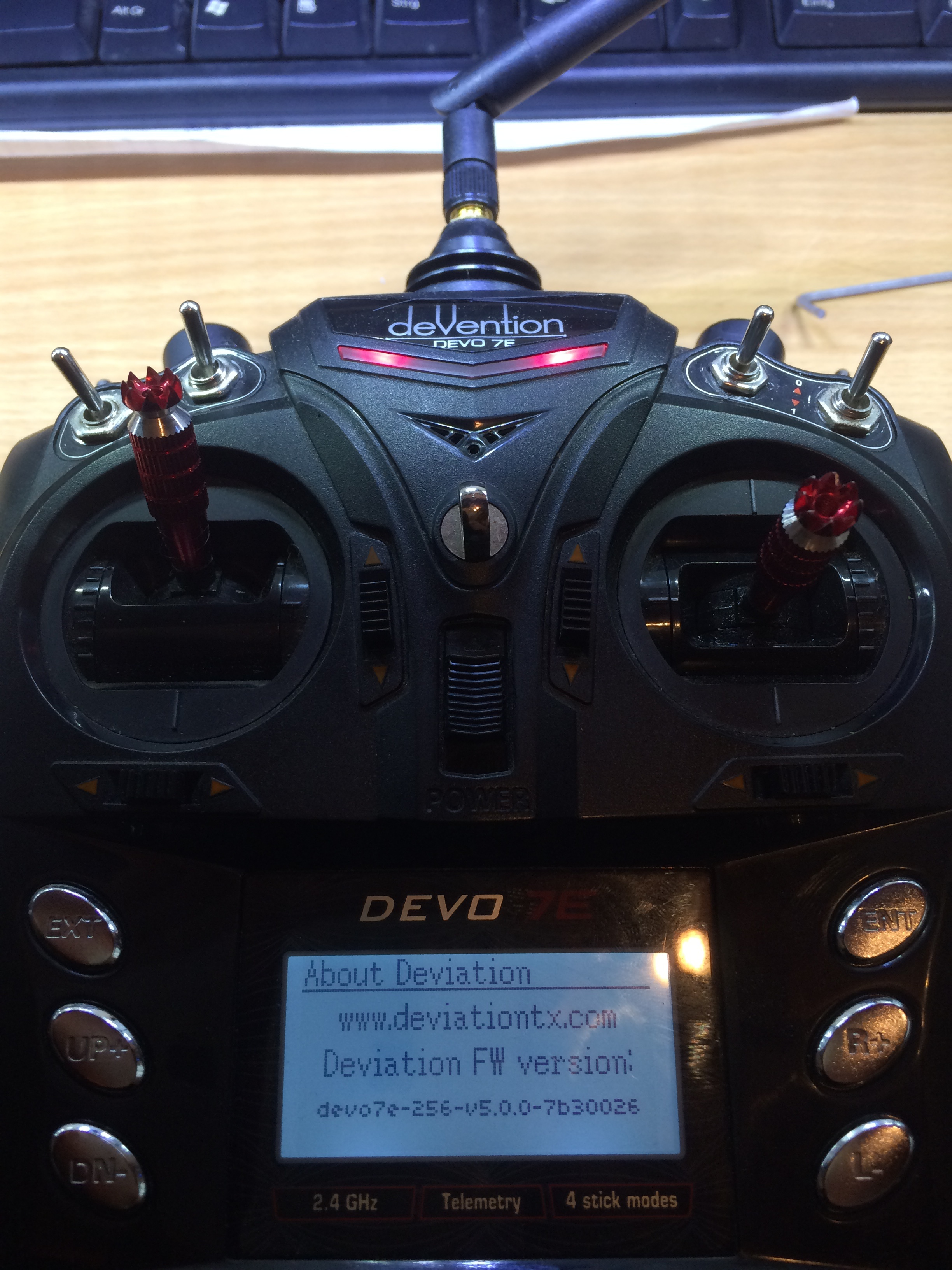

05 May 2017 01:34 - 05 May 2017 06:14 #62011
by compman2
Thanks for you help. The jumper did indeed get the usb problem fixed. I was able to load deviation and the file subsystem. I am ordering a replacement transistor. Any idea how it fried? Could it have been shorted pins on the MCU?
It was such a mystery to me why it wasn't working because the solder joints on the mcu look so good. All is well now. I was about to do another mcu swap which wouldn't have fixed the problem. Thanks so much for you help silpstream!
Another Ultimate 7e in the wild!
Replied by compman2 on topic Ultimate7e tutorial: Processor upgrade
silpstream wrote: If you are only getting 0.7v then something is definitely wrong. try running the jumper between Pin 2 to Pin 3. This should just be temporary though, so change the transistor when you get a chance. It's a SS8550 in a SOT23 package. Easy to find.
Last edit: 05 May 2017 06:14 by compman2.
