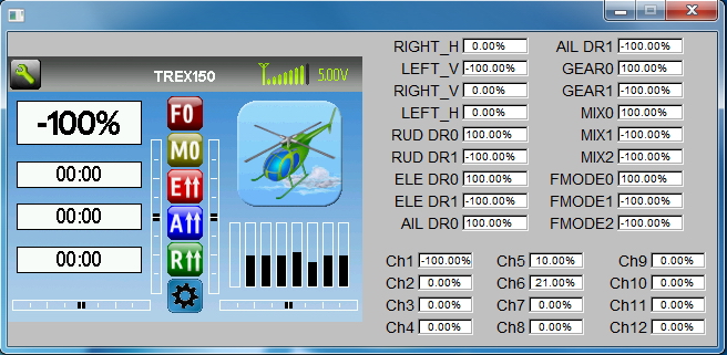

08 Jan 2014 16:25 #18224 by Tom Z
Replied by Tom Z on topic Walkera V450D01/D03 - Beginner Settings
Thanks for the detailed explanation!
This is great news for me as it will save me a ton of time making models for different transmitters. Also I can now post the model will work on all supported deviation transmitters - DEVO 6/6S/7e/8/8S/10/12/12S
I did use the icons within the first thirty.
I deleted the [gui-NNNxNNN] section on one of my a models. Here it is. Can you check to make sure I did it correctly?
Can the people who download the file just install and use it?
Then if they want to customize their screen layout they can.
I didn't change any screen layouts except I added icons for DR and Gear.
3 of the 4 icons I assigned were the same when I loaded it into the Devo 8 emulator after I deleted the [gui-NNNxNNN] section.

08 Jan 2014 19:08 #18239 by Tom Z
Thanks Bud!
It works great. I added what you posted into one of my models.
I then loaded it into my Devo 7e, 8, and 10 emulators. All the icons display and work correctly with the switches they are assigned to.
I am now updating all my V4 models with this one model for all transmitters

16 Jan 2014 03:50 #18553 by Tom Z
I used the Devo 7e, 8, 10 , 12 emulators and my templates are now done and my custom layout file is ready to post. Now I have to edit my models and remove the GUI section and include the custom layout file with it.
Here is what the Devo 8 looks like with Small Box Timers.
16 Jan 2014 05:20 - 16 Jan 2014 05:21 #18554 by WheresWaldo
Replied by WheresWaldo on topic Walkera V450D01/D03 - Beginner Settings
I always thought the timers were too big, looks much better with the small boxes. In the emulator holding the down arrow key will get you to quickpage1, I don't have an emulator running here so I can't test right now.
You don't need to use the 7e and 10 emulator since the GUI is exactly the same, just use one or the other.
Last edit: 16 Jan 2014 05:21 by WheresWaldo.
