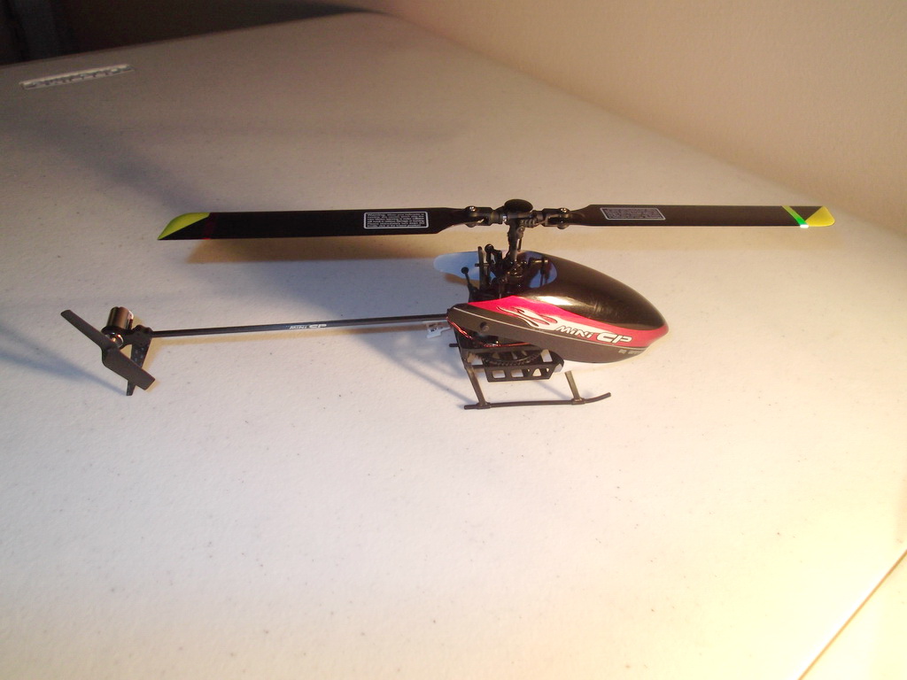

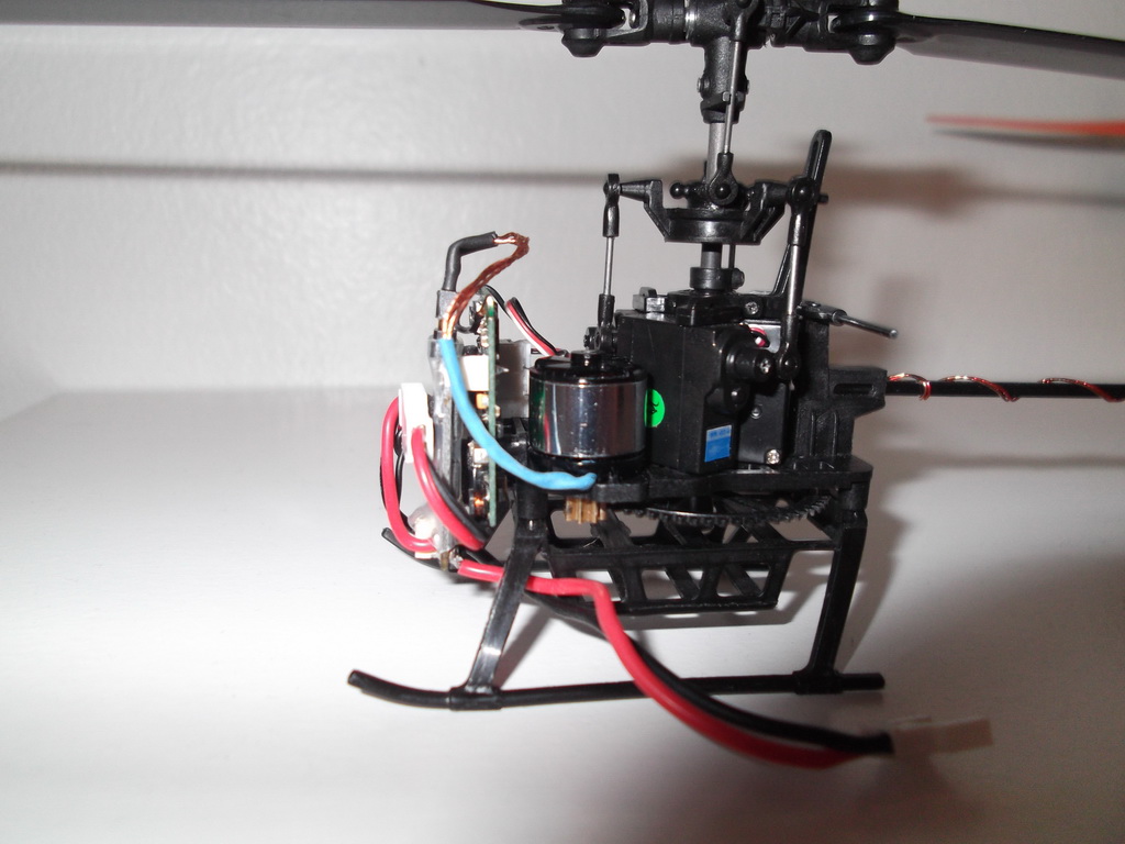

Here is my Mini CP with the HP05S and 10A V3 PnP ESC with the BLheli Software.
If you need more power sometime you can use the HP05S motor for wicked power and headspeed!
- HP05S 13,600kv motor w/1.5mm motor shaft
- 8T 1.5mm shaft size M0.5 pinion
- 10A V3 PnP ESC with the BLheli Software
- 7mm tail motor
