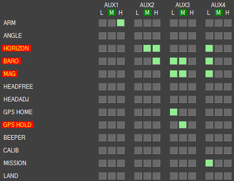

Set up for Spektrum DSM2 receivers (I use a LemonRX 8ch).
Arm Switch has "OK" symbol for disarmed, exclamation mark for armed. (HOLD switch)
GPS has arrow down symbol for Position Hold, house icon for RTH. (Left 3 position switch), third position is off and blank.
Mag switch has compass symbol (FMODE switch), off is blank.
Flight modes are no self level (SL off icon), horizon or angle mode (SL on icon), horizon or angle mode with baro (Alt symbol).
The modes will of course have to be set up on the board too to match this.
toggle3 goes into /media
qmini goes into /modelico
model3 goes into /models (rename as needed)

Update:
Changed layout, additional switches (2 virtual switches using the right side trims, up/down trim switches my gimbal to point down or straight, left/right trim switches between cameras on my quad).
Right side trims disabled (shouldn't need to be used on a properly calibrated quad).
Changed to 12 channel DSMX receiver (sbus), adjust to match your receiver!
New model icon.
New mission mode icon.
Camera position icon.
Video 1/2 icon for multiple cameras.
Icon order now matches switch order.
From the left: Armed/disarmed, RTH/POSHold/Off, Selflevel on/off/AltHold, Mission on/off.
Below: Camera up/down, Video 1/2.
Remove the date from the attachments.. not sure why the forum seems to think it a good idea to automatically add that.
New model icon.
