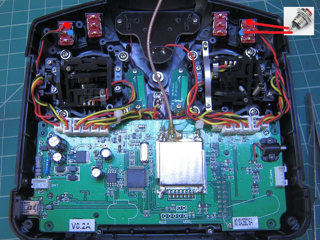

To set up a momentary switch on a Devo 7e (the throttle Trim seems to be convenient for quads since you don't need trim on the throttle), I use 3 steps.
In the Mixer menu, set up a virtual channel Virt3 with Src None, leave the other settings at default.
In the Trims menu, set up a new trim with input as Virt3, step Momentary and Trim+ as TrimLV+. Leave the switch as none.
In the Mixer menu, set up channel 6 as a simple mix, Src Virt3, 1-to-1 curve.
If you've done this correctly, you can use the Transmitter Menu, Channel Monitor to see the results. When you press the Throttle + trim button, you will see channel 6 go from -100 to 100.
An alternative is to add a real momentary button to your transmitter.... I just hardwired a tiny momentary pushbutton in parallel to my FMODE switch and mounted it where I can press it easily. My photo shows it connected to the Hold button, but it works on either one.
