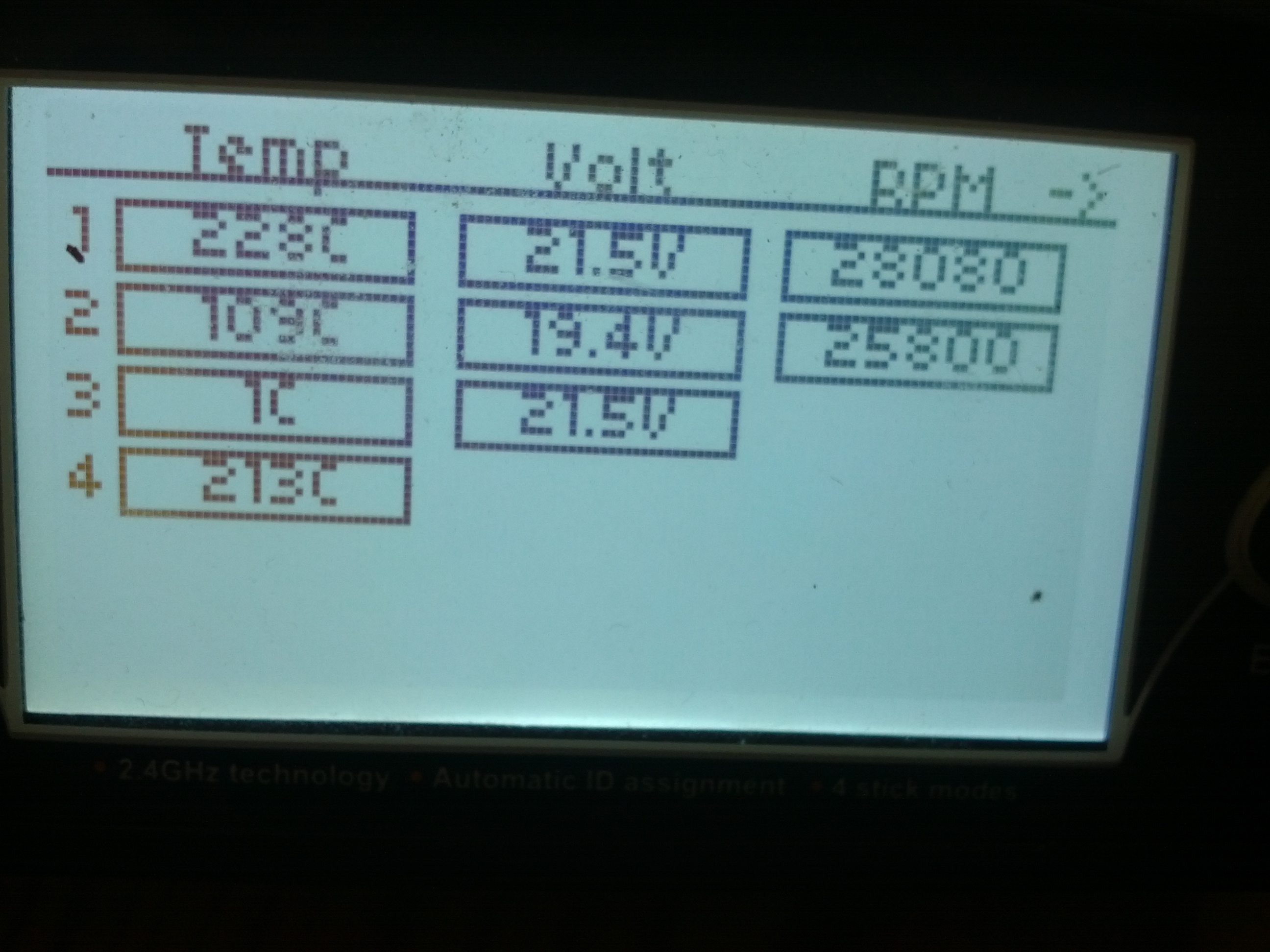

Sorry,
devo10-v4.0.1-8d9113c isn't the solution.
Telemetry monitor shows strange values:
either:
Temp1=Temp2=Temp3=Temp4=29C
Volt1=Volt2=Volt3=4.8V (1s Lipo)
RPM1=RPM2=5760
or even:
some other values:
should I write down them?
either:
RPM1=RPM2=5760
or even:
some other values:

05 Mar 2015 16:29 - 05 Mar 2015 16:36 #29357
by linux-user
Yes, that is true, but none of the values displayed are valid.
I don't think it is necessary to change the name. "Virtual channels" are also sort of channels.
Channel Monitor:
does not work with small fonts. (/media/config.ini)
USB:
is working, sorry might have been my fault.
Telemetry monitor:
no valid values as described above. (MiniCP only supports Temp1 and Volt2)

Sorry,
Telemetry Monitor:
now all "0" in "error color" (=inverted), no matter if RX is bound or not.

Hi, Indigo
deviation-devo10-v4.0.1-de99565
Channel Monitor - fixed - confirmed
Telemetry Monitor:
still showing all 0, no matter if model bound or not. (inverted)
To clarify: This is not only the "Telemetry monitor" but TX doesn't display any telemetry-values in text-box as well.
