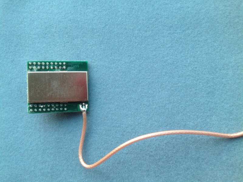

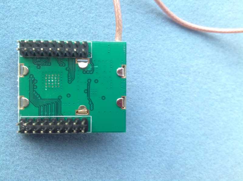

- panosnl
- Posts: 10
29 Sep 2013 17:12 - 29 Sep 2013 17:13 #14137
by panosnl
Replied by panosnl on topic HiSKY protocol
Last edit: 29 Sep 2013 17:13 by panosnl.
- victzh
- Posts: 1386
29 Sep 2013 18:13 #14138
by victzh
Replied by victzh on topic HiSKY protocol
@panosnl, probably it can be used, but the chance is it has Beken chip, not nRF24L01. It's not bad by itself - our code supports Beken, and original modules from V202 work in Devo. Also, I am not sure about Power Amplifier, but judging by the metallic case, it has it.
You need to figure out the pinout, though. You're lucky - metallic case is not soldered, just has bent tabs. If you could make a detailed photo of insides, I can guide you in this.
Another option is a module from eBay for $5-7. Pay attention to Power Amplifier, search for "nRF24L01 PA".

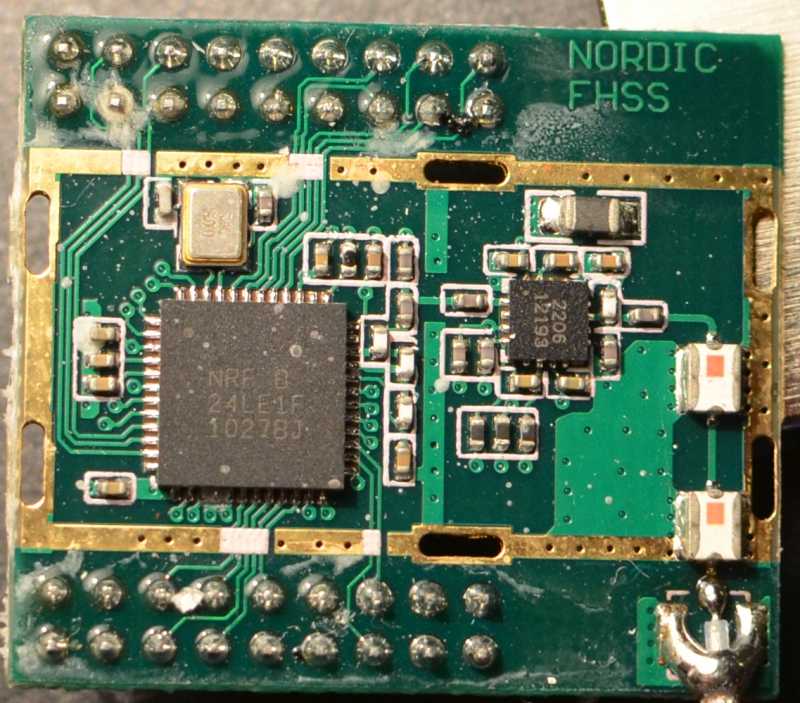

- panosnl
- Posts: 10
30 Sep 2013 18:16 - 30 Sep 2013 18:17 #14179
by panosnl
Last edit: 30 Sep 2013 18:17 by panosnl.
- victzh
- Posts: 1386
30 Sep 2013 19:41 #14181
by victzh
@panosnl, it sucks. nRF24LE1 is an integrated 8051 MCU and nRF24L01 RF. So the protocol is implemented inside of this integrated chip and its pinout is specific for the rest of the V922 TX. No way to use it in Deviation.
I'd recommend you to buy the following one: www.elecfreaks.com/store/nrf24l01p-pa-lna-v31-p-142.html
or something else based on nRF24L01+ (pay attention to the plus at the end). It is a bit more future-(and past)-proof. It support all the bitrates of nRF24 family. You need an antenna for this chip, if you remove the connector you can use your antenna from V922 TX, or you can buy 2.4GHz antenna on that site (and on many others).
