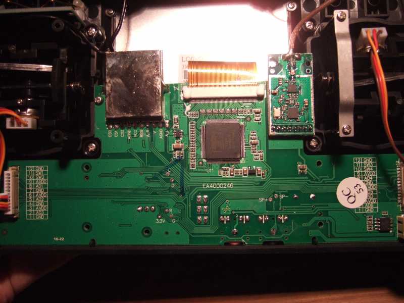

HappyHarry wrote: guys i'm being given an H107L as a late christmas present and i'm wondering is it possible to pull the a7105 module from the stock tx? or will i need to order one elsewhere? if so any reccomendations?
thanks in advance
There's no module in the H107L TX, you'll have to find another one, search ebay for a7105-500m for example.
29 Dec 2013 22:12 #17437 by HappyHarry
Replied by HappyHarry on topic New Hubsan Upgraded Version on the way
thanks for the info, i take it the chip is hardwired into the main pcb then?

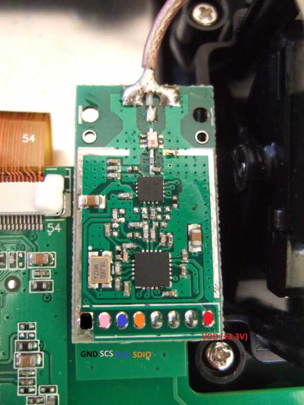

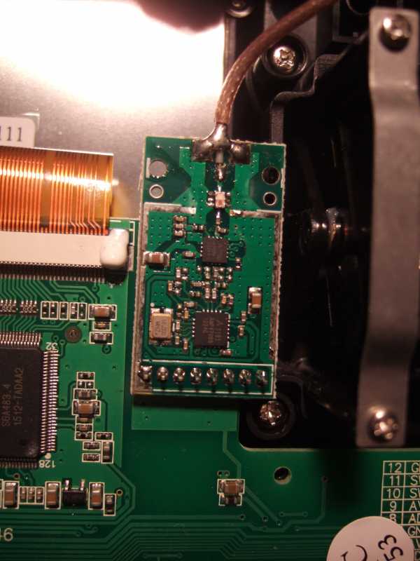

29 Dec 2013 22:30 - 29 Dec 2013 22:32 #17439 by SeByDocKy
Replied by SeByDocKy on topic New Hubsan Upgraded Version on the way
Sorry, I inserted the wrong photo

29 Dec 2013 23:20 #17442 by goebish
Replied by goebish on topic New Hubsan Upgraded Version on the way
SeByDocKy wrote: Sorry, I inserted the wrong photo
We can't see the traces, they must be underneath the 2.4 RF module, if you have a multimeter with fine tips you'll have to find the connections from the a7105 chip sdio, sck and scs to the module header pins.
29 Dec 2013 23:31 #17443 by SeByDocKy
Compare to your scheme and my photo, the point is located on top right. So there is a rotation of +90 deg.... I think it's easy to find all those pins :)
29 Dec 2013 23:38 #17444 by goebish
Yes, they are easy to find on the chip, now you've to trace the 3 interesting pins to their corresponding pins on the module header
Unless you want to try to solder wires directly on the QFN chip :P

30 Dec 2013 10:36 #17476 by goebish
HappyHarry wrote: thanks for the info, i take it the chip is hardwired into the main pcb then?
Yes:
