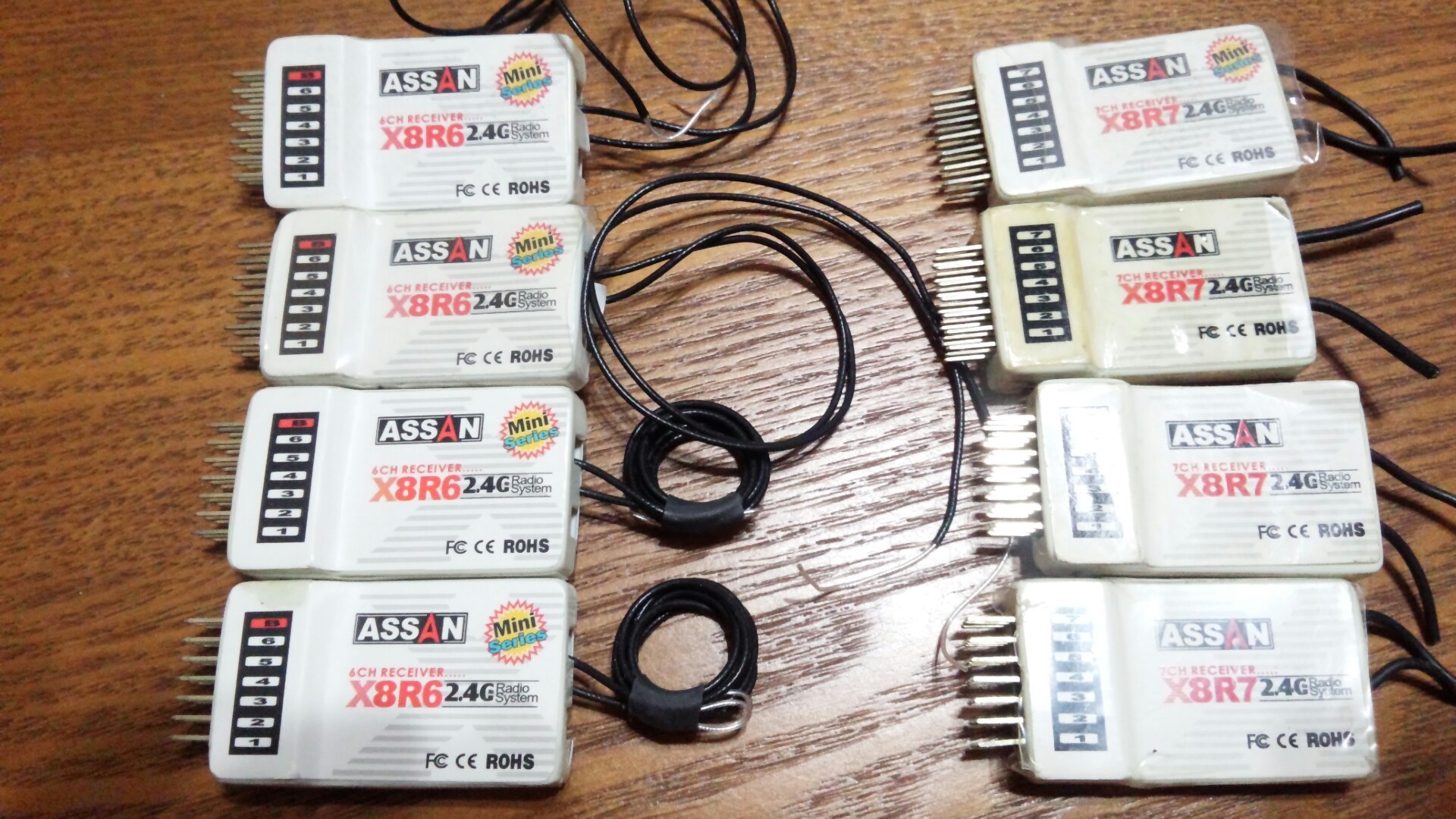

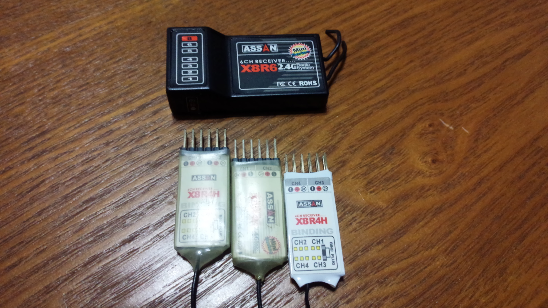

08 Jan 2017 07:25 - 08 Jan 2017 07:26 #57674
by TF824
Replied by TF824 on topic What about Assan?
I flashed deviation-devo7e-v5.0.0-f395b75 and overwrite the protocol.
Succeeded half way,,,, Tested all of my 12 ASSAN RX's.
I have 4 different kinds of ASSAN RX's
1, X8R6 Black color ---- Worked perfect !!! but problem is I have only 1 this type receiver,,,,
2, X8R4H White color ----All 3 worked perfect !!!
3, X8R6 White color ---- All 4 after binding, RX showing slow RED blinking,,,,No success,,
4, X8R7 White color ---- All 4 after binding RX showing solid Green but none of channels moves servos,, No success,,,
Any idea why this thing happen??
