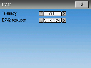

01 Nov 2013 12:20 - 01 Nov 2013 12:22 #15192
Replied by rbe2012 on topic 18 channels for DSM2 / DSMX ?
For testing simply add one line in dsm2.c and you get Model.proto_ops[1] Model.proto_opts[1]=0 for 1024 and =1 for 2048:You can use it where needed.
static const char * const dsm_opts[] = {
_tr_noop("Telemetry"), _tr_noop("Off"), _tr_noop("On"), NULL,
_tr_noop("Resolution"), _tr_noop("Steps: 1024"), _tr_noop("Steps: 2048"), NULL,
NULL
Last edit: 01 Nov 2013 12:22 by rbe2012.

01 Nov 2013 17:36 #15205
The protocol options are not conditional. You can set them to any value in any case.
It is part of the code to decide if it's used. Maybe we can show an explanation or hint near the option, but it has to fit in the first field of the array (resp. on the screen where it is located actually and not hidden behind the value box).

02 Nov 2013 07:55 - 03 Nov 2013 07:28 #15218
Replied by vlad_vy on topic 18 channels for DSM2 / DSMX ?
It seems all issues solved. But it required thorough testing.
Cesco, can you test all modes: < 8 channels (1024), > 7 channels (1024), > 7 channels (2048), X-Plus cnannels?
At protocol options page you can select all you want, but:
1) if you have number of channels < 8, next time you visit protocol options page you will see 'DSM2 resolution' = 'Steps: 1024';
2) before you can get number of channels > 12 you have to select 'X-Plus channels' = 'On';
3) if you select 'X-Plus channels' = 'On', number of channels > 7, next time you visit protocol options page you will see 'DSM2 resolution' = 'Steps: 2048', you don't need select it manually, it will change automatically;
4) X-Plus channels started from 13 channel (X-Plus 1), 14 channel (X-Plus 5), 15 channel (X-Plus 2), 16 channel (X-Plus 6), and so on.
For DSMX protocol resolution is always 11bit(2048).

02 Nov 2013 09:34 #15224
I think you can force the right values to be shown directly, not only after revisiting the page. I'll have a look later.
vlad_vy wrote: I1) if you have number of channels < 8, next time you visit protocol options page you will see 'DSM2 resolution' = 'Steps: 1024';
