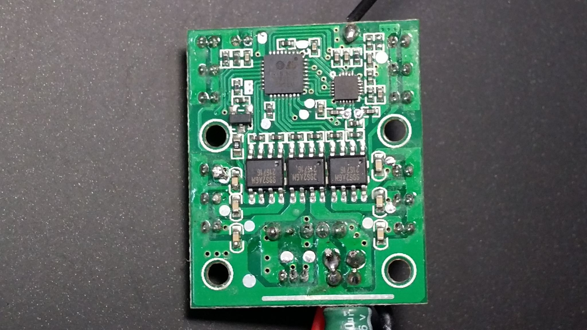

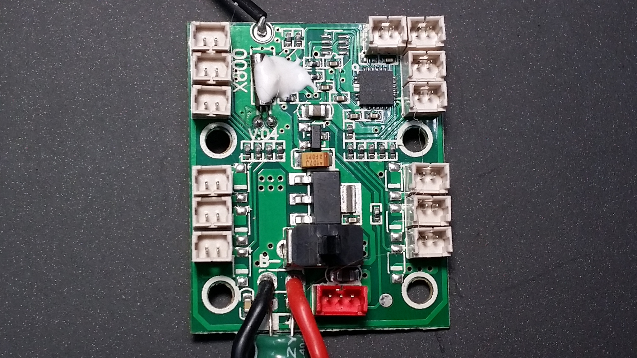

Deal57 wrote: A lot of these boards have test points that we can use instead of the chip pins. Can you post a photo of the board straight on both front and back?
Hi Deal57,
It's good to see you here again,you help me a lot.
Here's X600 receiver board picture:
Front:
Back:
Thanks a lot.

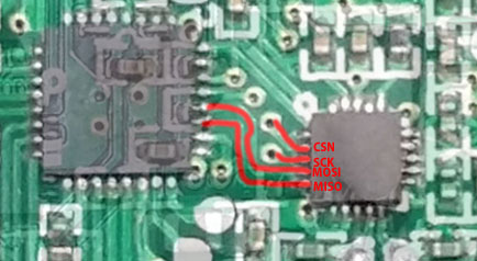

24 Jul 2015 15:17 #35917 by Deal57
Replied by Deal57 on topic which is MJX use protocol ?
Wow. This doesn't lookeasy. Examining these photos, I don't see any test points on this board that we can use. CSN and CLK lead to via holes that could be easier to solder, but MOSI and MISO seem to go directly from the XN297 to the FC chip. With these really tiny solder points you would need really good eyes and a really steady touch!
I merged the front and back photos and set the back at 25% opacity so I could see if there were any traces we could use. This illustrates the best results I could get. It is POSSIBLE that there is something underneath the crystal on the back side that is connected to MOSI/MISO but I think it unlikely.

Thanks Deal57!
I will check the connection.
