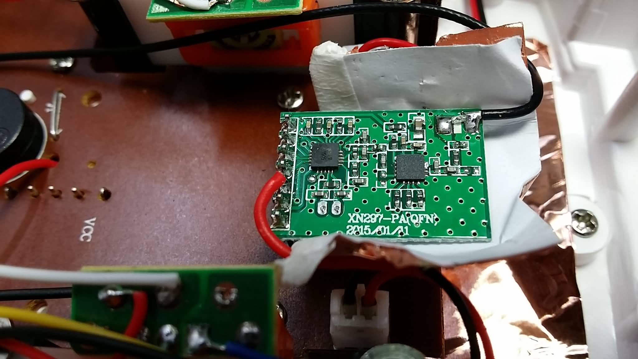

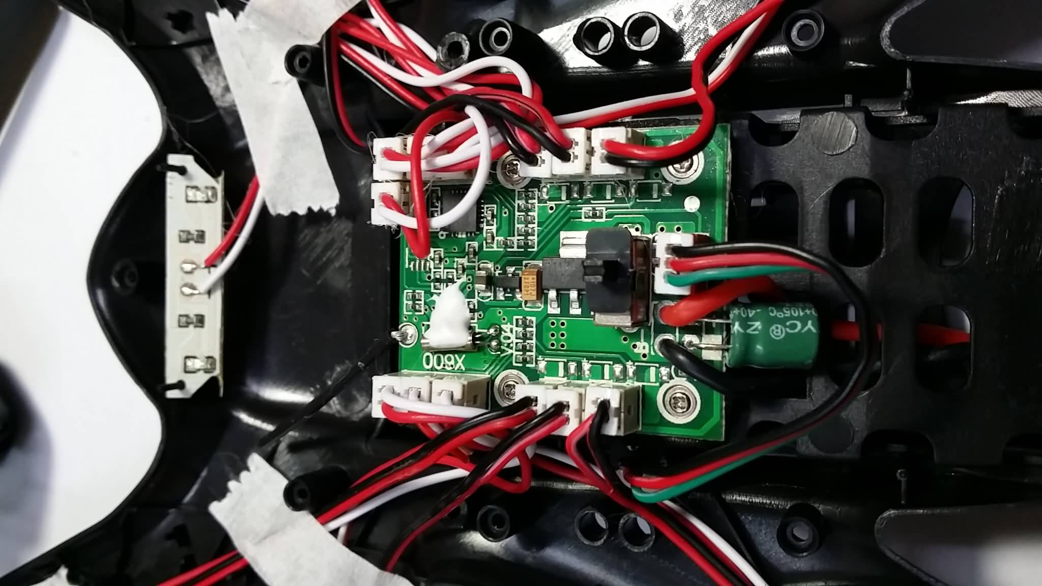

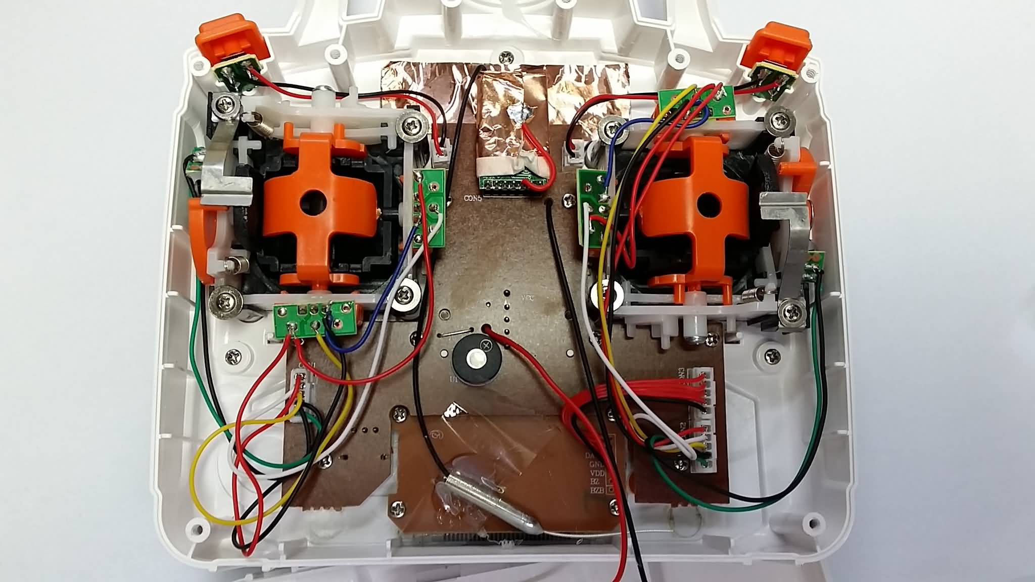

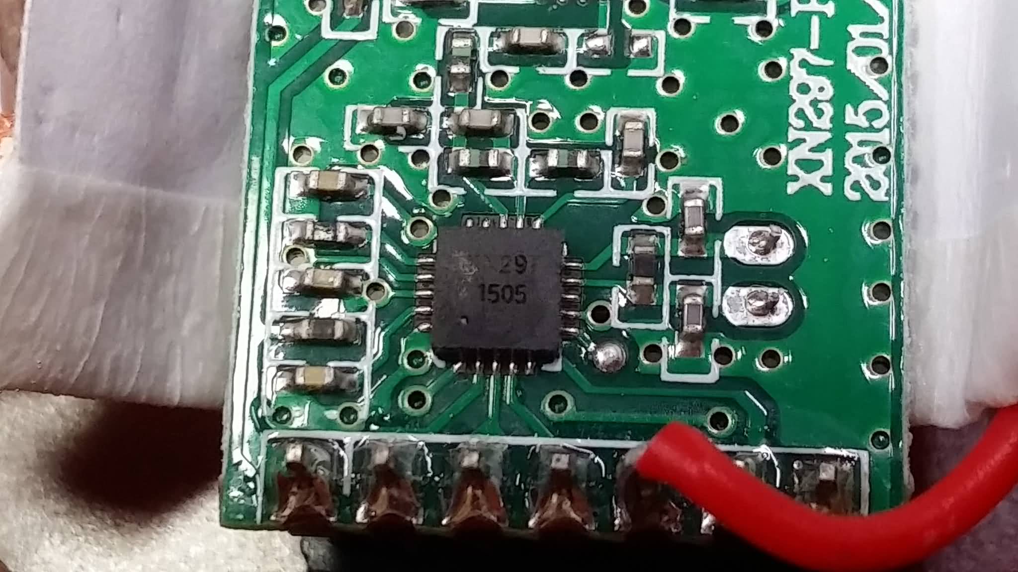

05 Jun 2015 00:50 - 05 Jun 2015 00:51 #33446 by dc59
Replied by dc59 on topic which is MJX use protocol ?
Here comes MJX X600 TX/RX board picture,it's using XN297 chip.
Last edit: 05 Jun 2015 00:51 by dc59.
