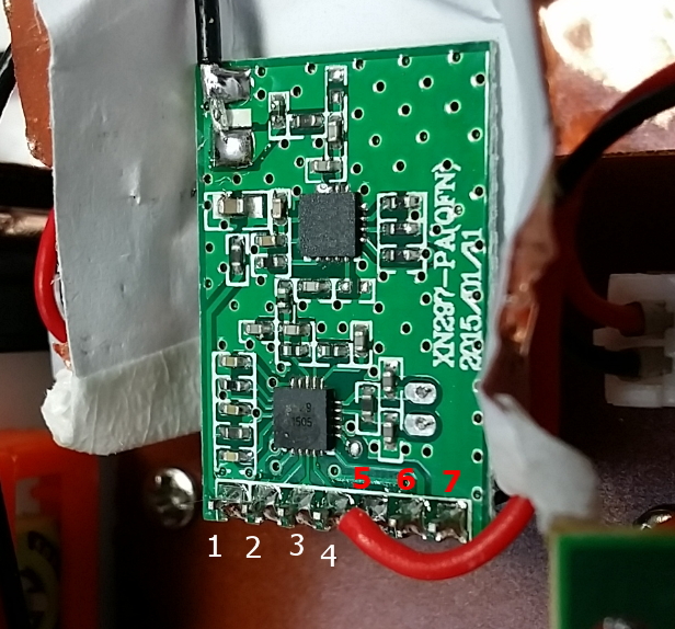

Do you know XN297 pinout?
I measure voltage of each pin
1. 3V (3.3V Vcc ???)
2. 2.36v
3. 2.04v
4. 1.14v
5. GND
6. 0.06v
7. 0.85v
I want to capture SPI data,but I don't know MISO / MOSI / CLK / SCK pin or I can just try and error?
Thank you very much.

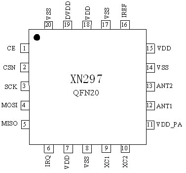

I found a schematic of the XN297 that might help.
It appears to me that pins 2, 3 and 4 correspond to CSN, SCK (clock), and MOSI; these should give you a good capture once you determine a ground pin. I can't tell from the photos where the 1st or 5th pin from the processor is connected, but that the processor's CE and MISO; they might not be needed to get a capture. I'm not entirely sure you've got ground and 3.3 right..the red wire to pin 5 would suggest there is Vcc on that pin? Where does that red wire go?
Here is a good example of what the team did with the CX-10 Green board. The chip pins are the same and you might be able to follow the process there. On that one the MISO wasn't connected, and it looks like just capturing CSN, SCK and MOSI got what was needed.

I used resistance gauge to check pin connection,
1, VDD
2, CSN (enable)
3, SCK (clock)
4, MOSI
5, GND
6, MISO
7, CE

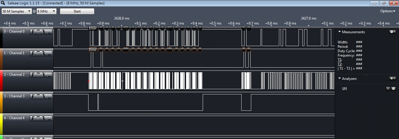

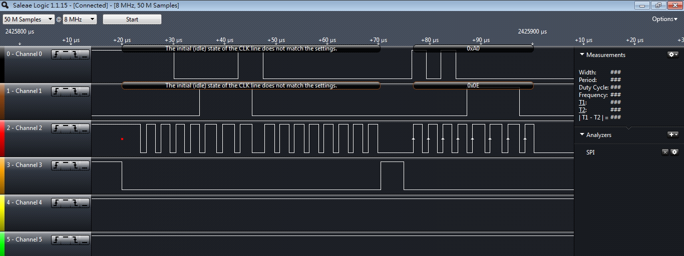

But I got some problem when I captured SPI data,there is some error occur :
Could anyone help?
ps. the red wire on pin 5 connect to copper foil, I think it shield some noise.

I think that the display isn't set up for the SPI decoder to do its job. I just added a note to the SPI Capture Guide topic that may help you set up the SPI analyzer settings.
Let me know if I can elaborate or clarify any of those notes.
