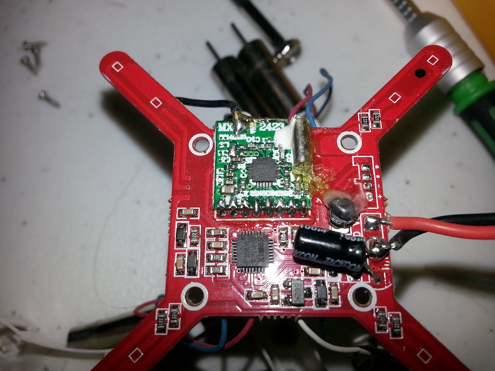

- greenfly
10 Jun 2015 18:45 #33795
by greenfly
Replied by greenfly on topic HontaiTec Quadcopters (HT F801, HT F803,...)
Yes, that sounds right.
I will be able to do RX side captures as well... but I have to take the whole quad apart to get to the pins.
- Durete
- Posts: 610
10 Jun 2015 18:49 #33796
by Durete
Replied by Durete on topic HontaiTec Quadcopters (HT F801, HT F803,...)
Yep, it's the same RX module
In fact, the main difference between your TX and mine, is your has a RF module without PA(probably the same mounted at RX side) and mine with PA.
