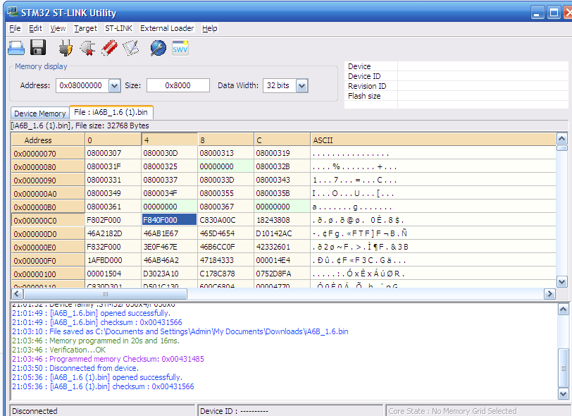

hi Goesbish
i read on Rc group , you say
optional: open it in an hex editor then change the 4 bytes at offset 0x1C00 (12 34 56 78) to change RX ID, I think you can use any arbitrary values, just avoid using FF FF FF FF
i still not understand this problem , Open hex editor ? can you show me a photo ?

I open file IA6B , but i see it diffirence your photo ? why on your photo, so much FFFFFFF but i m not ?

because you've not navigated to offset 0x1c00
