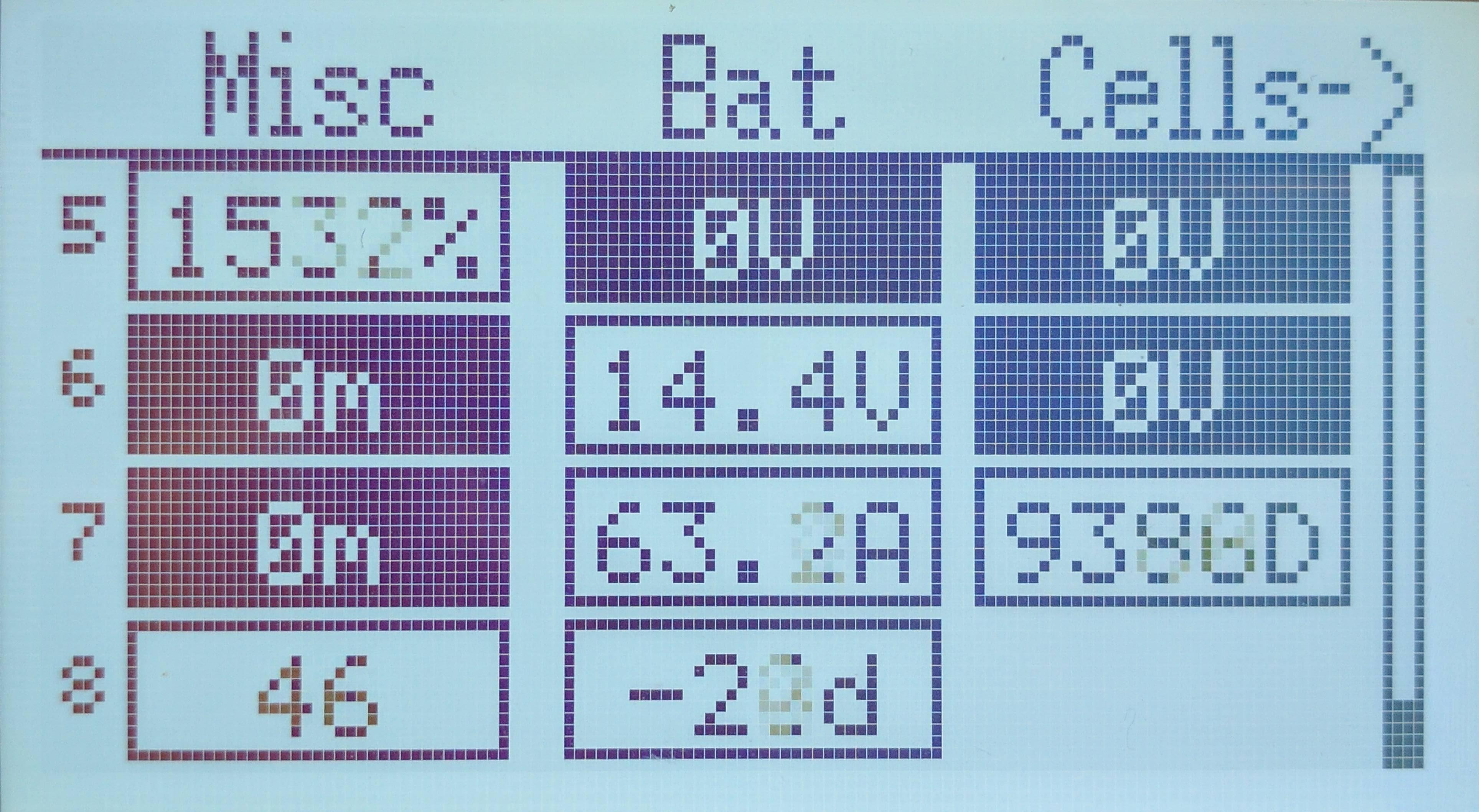

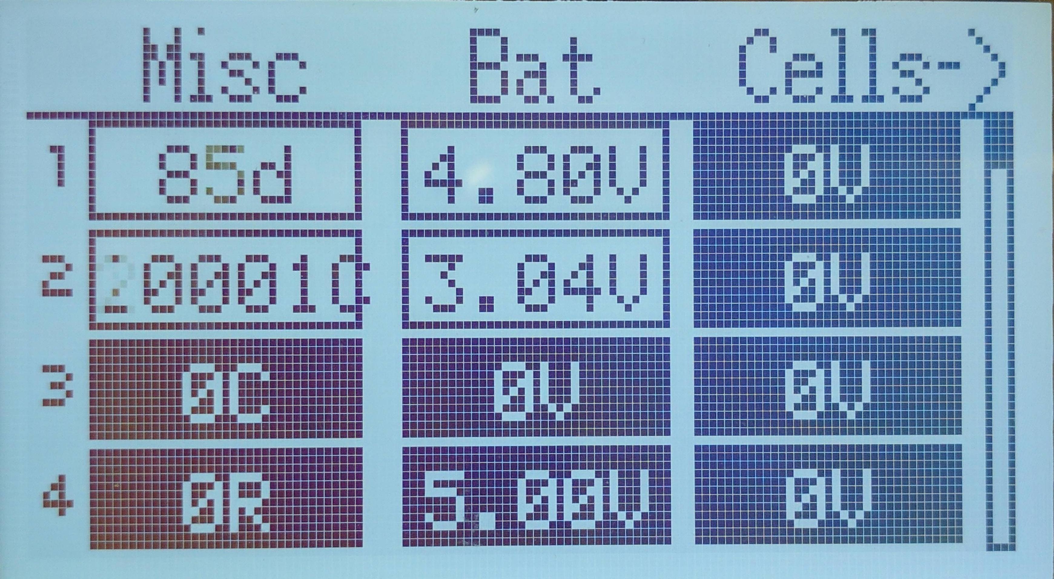

\o/ \o/ \o/ So I currently have 3 new aircraft:
For all of the three aircraft I selected the FCC protocol type (because it wouldn't bind with EU) and then I set the fine freq number to -60. It binds somewhere between -127 and -10; it won't bind with the default 0. This has been already covered earlier in this thread anyway, but I thought I'd mention it in this context (with these particular drones) for others to find.
The Loki-X3S is the most interesting one. The E-shop doesn't say explicitly whether you're getting an 8-channel or 16-channel FrSky. But yep, it's a 16-channel thing, again supported by FrskyX. It has telemetry and there's a lot of hard-to-grasp telemetry data.
Screenshots are attached. Most of it looks random, but values that make sense are TelemVAmp (battery voltage), TelemRSSI (probably the transmitter's signal strength from the drone's perspective) and LRSSI (probably the telemetry signal strength as the transmitter gets it back). (I switched my Devo 10 between 100 microwatts and 150 milliwatts a few times and TelemRSSI did change, whereas LRSSI did not.) (Then there are a few other voltages; not sure what those are.)
The smaller Lokis don't seem to have any telemetry installed. <totally_off_topic>Sadly, they also don't have any working onboard voltage monitoring in the Lumenier spec (the more powerful one). You can have either proper voltage monitoring or (much) more power, but not both, at least at the moment. That's just how it is.</totally_off_topic>
