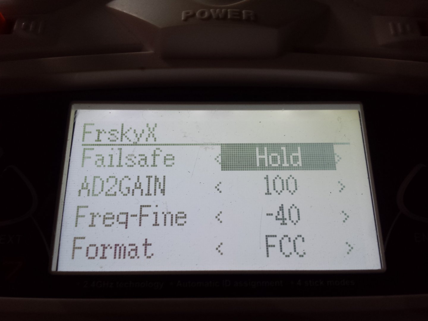

09 Nov 2017 17:34 #65668 by KampfGurke
Replied by KampfGurke on topic New FrSkyX protocol
What can i do to get RSSI on my OSD with a XSR receiver?
Telemetry works for me, I can see VBat,mAh, LRSSI,LQI,CRNT..... but there is no way to Send that LRSSI value back to my Flight controller :(
With a X9D you can put that Telemetry value back to a Channel you want, but is there any way to do that in Deviation?
I don´t want to use the Rssi pad on the RX/FC, it would be cleaner if there is another option :)
09 Nov 2017 19:28 #65670 by Moeder
Replied by Moeder on topic New FrSkyX protocol
If I recall correctly, FrSkyX protocol has a protocol option (press ENT on the protocol in model setup and scroll down) to send LRSSI back on the last channel.
09 Nov 2017 19:41 #65671 by KampfGurke
Do i need the latest nightly for that?
With vlad´s Build from i think 08/17, it looks like this:
There are only 4 Options!
09 Nov 2017 21:45 #65675 by Moeder
The feature was added in March 2017, but vlad missed including it in his build until October 27th. Remember you will have to scroll down, as there only four protocol options displayed at one time.
