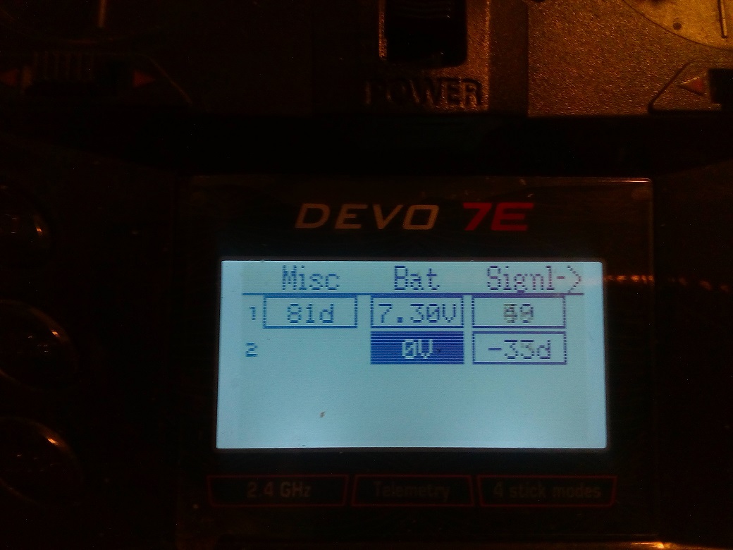

18 Apr 2018 17:22 #68725 by andreypav
Replied by andreypav on topic New FrSkyX protocol
Good day!
Could you please help me.
I've devo7e + frskyx4r reciever (new).
Use last night build firmware.
I'can't see AIN (Volt2)
Is is bug in the firmware or reciever is fault?
18 Apr 2018 19:17 #68729 by Fernandez
Replied by Fernandez on topic New FrSkyX protocol
Did you set value for the multiplier ratio in the protocol submenu, I find this bit of confusing....
19 Apr 2018 06:52 #68739 by andreypav
I've checked the multipler value. There are 100.
I confused that the voltage value is "shaded" and do not updated.....
20 Apr 2018 14:30 #68764 by hexfet
The shaded background does mean the telemetry value is not being received. What voltage are you applying to the AIN input? Maybe the receiver doesn't send if below a certain threshold.

21 Apr 2018 16:05 - 21 Apr 2018 16:09 #68782 by andreypav
hexfet wrote: The shaded background does mean the telemetry value is not being received. What voltage are you applying to the AIN input? Maybe the receiver doesn't send if below a certain threshold.
If I measure the voltage on the disconnected AIN pin, there are ~3.3V
If I touch the AIN pin and ground, the voltage descend to ~0.4V (I've short circuit through hand)
I've tried to apply to AIN pin 1.5V-3.8V...
Multiplier changed from 0 to 2000
Result: no changing.... on the telemetry is 0V....

22 Apr 2018 00:10 - 22 Apr 2018 00:11 #68785 by hexfet
andreypav, you have found a problem in the documentation. The VOLT2 telemetry value is not available on the 7e in the FrskyX protocol. It is available in Frsky, and those two protocols share the same telemetry display code which is why it appears on the telemetry monitor page. The Frsky protocol includes the VOLT2 value in the standard receiver telemetry, but in FrskyX it is sent in the extended telemetry (s.port) packets which are not supported on the 7e due to memory limitations.

22 Apr 2018 06:56 #68788 by andreypav
hexfet wrote: andreypav, you have found a problem in the documentation. The VOLT2 telemetry value is not available on the 7e in the FrskyX protocol. It is available in Frsky, and those two protocols share the same telemetry display code which is why it appears on the telemetry monitor page. The Frsky protocol includes the VOLT2 value in the standard receiver telemetry, but in FrskyX it is sent in the extended telemetry (s.port) packets which are not supported on the 7e due to memory limitations.
Ok! Now I understand! Thank you very much!
