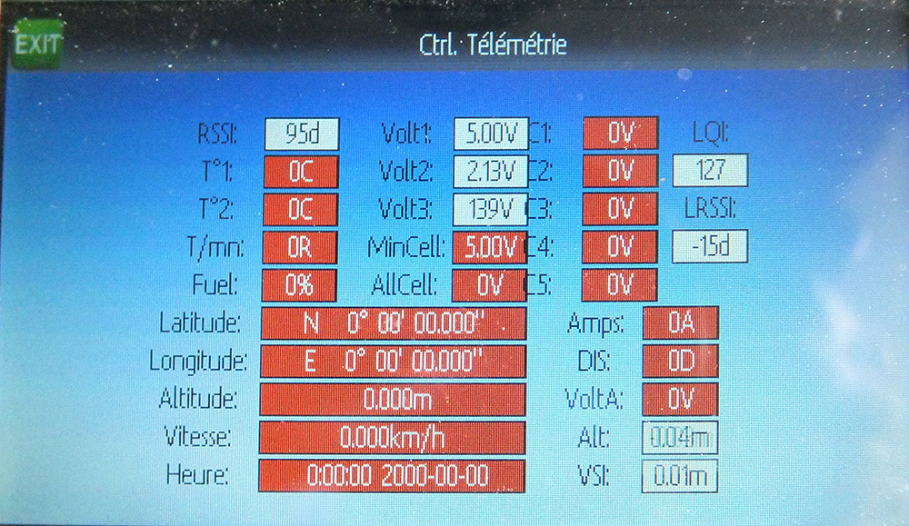

Hello
I am using a Frsky G-RX8 receiver with the Frsky x protocol on my devo 12s
All seems good but I cannot reset the telemetry altitude. Each time I bind the rx the altitude is 15 m or so.
Is it a way to reset this value ?
Thanks for help.
Morlacus
Thanks for help.
Morlacus
Last edit: 12 Jun 2018 07:19 by Morlacus.

13 Jun 2018 08:02 #69628
by Morlacus
Replied by Morlacus on topic New FrSkyX protocol
Hello
I have tested the build
The V3 shows 0 before turning on the Rx.
With Rx on it shows 113 and the altitude is approx 11 meters
the value of the altitude comes apparently immediatly
Regards
Morlacus
Regards
Morlacus

13 Jun 2018 18:15 - 14 Jun 2018 01:18 #69631
Very strange. The two numbers should be the same magnitude, but seem different by a factor of 10. Was confused by another test...
What is the altitude above sea level where y'all live?
The test build is updated (same build number) with a protocol option named ALT TEST. Setting this to Enabled will reset the internal "ground level" value to zero. It will then be set internally to the next received altitude value, which should cause the displayed altitude to stay near zero. Let's see what the VOLT3 value becomes after using this option. Please take a screenshot.
The protocol option will immediately be set back to disabled by the protocol code, so don't be surprised if you don't even see it displayed as Enabled. Choosing enabled will still reset the saved ground level.
Last edit: 14 Jun 2018 01:18 by hexfet.

14 Jun 2018 07:40 #69641
by Morlacus
Hello
I have tested the new build.
The altitude of my workshop is approx 55 m.
The altitude given by the rx is approx 11 to 15 m (could differ according to the weather conditions of the day)
When enabling the Alt test resets the altitude in the alt box to zero. the V3 shows 137 or so.
When turning off the Tx or the Rx alone (the other is on) the altiude is kept when the other is turned on.
If both Tx and Tx are turned off, when turning on both, the altitude shown is the same as before reseting (11 this morning)
So it would be necessary for the moment to reset the altitude each time. May be it would be good to have this possibility left in the protocol.
Regards
Morlacus
Regards
Morlacus

15 Jun 2018 07:51 - 15 Jun 2018 08:50 #69647
by Morlacus
Hello
The V3 value shows allways a red box with 0V
The alt shown this morning without doing anything is approx 11m
I did the following procedure
Tx on RX on alt :11 approx
Tx on - RX on - set alt test to zero - Tx on - Tx off - alt telem :0 - Tx off - Rx off - Tx on - Rx on - Alt telem 11 m approx
Tx on - RX on - set alt test to 1 - Tx on - Tx off - alt telem :0 - Tx off - Rx off - Tx on - Rx on - Alt telem 9 m approx
Tx on - RX on - set alt test to 2 - Tx on - Tx off - alt telem :0 - Tx off - Rx off - Tx on - Rx on - Alt telem 7.5 m approx
Tx on - RX on - set alt test to 3 - Tx on - Tx off - alt telem :0 - Tx off - Rx off - Tx on - Rx on - Alt telem 6 m approx
Tx on - RX on - set alt test to 5 - Tx on - Tx off - alt telem :0 - Tx off - Rx off - Tx on - Rx on - Alt telem 4 m approx
Tx on - RX on - set alt test to 8 - Tx on - Tx off - alt telem :0 - Tx off - Rx off - Tx on - Rx on - Alt telem 2 m approx
Tx on - RX on - set alt test to 10 - Tx on - Tx off - alt telem :0 - Tx off - Rx off - Tx on - Rx on - Alt telem 0 m approx
Tx on - RX on - set alt test to 50 - Tx on - Tx off - alt telem :0 - Tx off - Rx off - Tx on - Rx on - Alt telem 0 m approx
So from 11m the alt test has to be more than 10. A alt test automatically set to the first value or an average of the ten or so frist values sent by te Rx would be good.
Regards
Ps I wonder if there is a spare for the main switch of a Devo 12 S
Regards
Last edit: 15 Jun 2018 08:50 by Morlacus.

15 Jun 2018 17:03 - 15 Jun 2018 17:06 #69652
by Morlacus
hello
The altitude value changes very rapidly on the telemetry screen I would say probably more than 10 times by second. If it is the same rythm than the vario, it is very fast, the vario display is hard do read due to the change speed.
may be for a better accuracy you could leave the firsts 5 values (even if I have never seen weird values)
Regards
Regards
Last edit: 15 Jun 2018 17:06 by Morlacus.

One idea for deviation is to make some values on the telemetry test page clickable, with the action being to reset the value to zero. It seems possible but complicated. Another idea is to add a "reset telemetry" button to the model menu (possibly only if the protocol supports telemetry). This would reset all pseudo-telemetry values (like ground level, battery consumption, min cell value, etc). The things you'd want to reset between flights. I'm looking into these options - other suggestions welcome.
The results indicate the altitude value from the sensor takes some time to get to a steady value. It would be nice to know if the standalone vario sensor behaves the same, but still need a solution for the GRX8. If either of you have an FTDI adapter it would be helpful to get a capture of the telemetry.
OpenTX telemetry sets the "ground level" to the first altitude telemetry value received. The UI provides a way to reset the value to the current altitude. It also is reset if no altitude telemetry value is received for about 20 seconds.
19 Jun 2018 07:45 #69674
Replied by FDR on topic New FrSkyX protocol
There are already clickable labels in the UI code, at least on the color touchscreen ones: you can reset the timer by a long click on it's value on the main page.
So it is not impossible to implement, but probably all the protocols would need a callback function...
- Morlacus
- Posts: 181
19 Jun 2018 09:03 #69676
by Morlacus
Hello
The clickable button would be a good idea, It would be simple also to have a reset button in the protocol page where was the alt test.
- Morlacus
- Posts: 181
23 Jun 2018 12:07 #69696
by Morlacus
Hello
One more question on Frsky protocol
What is the best way to have the best tuning of freq fine ?
The manual says O or -41. At -41 i have no signal.
On the other hand the LQI stays at 127.
I have a signal for a freq-fine setting from -20 to 60. Is the best the average ?
Thanks for your advices
23 Jun 2018 18:58 #69698
Yes, the best will be at the midpoint of those two values.
