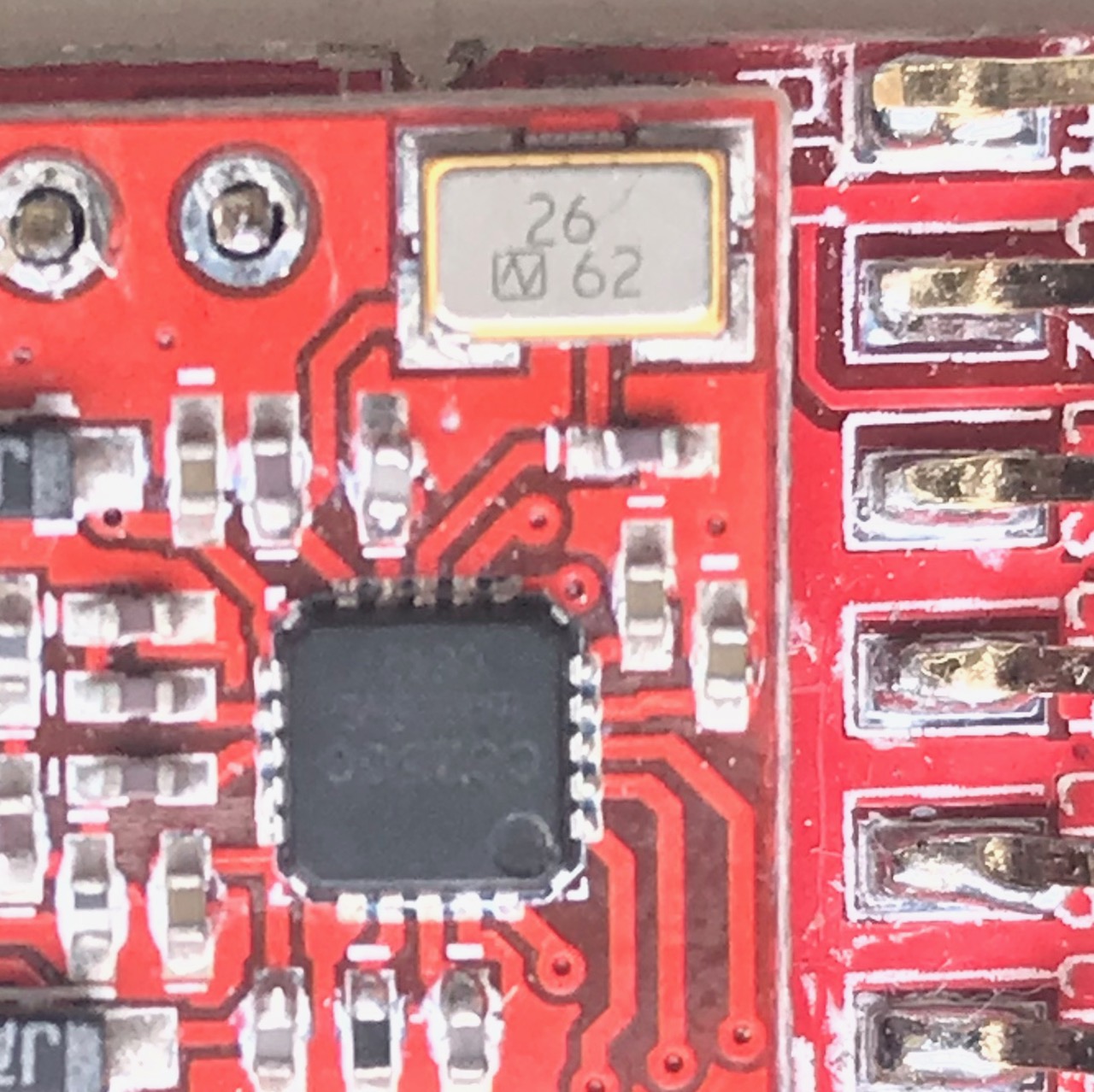

It is good time to verify range test anyway on cc2500, as reported before for Frsky (at least in the past) RF output deviation in 100uW, was way to high, I test field strength using 100uA meter and diode and compared to original Frsky, were in range check my wireless field strength meter not show anymore power.
The schematic for Tx module is public, it is XTAL SMD 4025 26M, surrounded by 15pf each side. I assume Rx uses same setup.
No idea what is used on a stock CC2500, or FRSKY, could be f.i. 10pf, than freq will move up higher, offset tune will goo down?

The Flydream X-tal is 26Mhz, both side 15pf to gnd, all FD receivers loose excactely bind at -2 fine, so it is not the tolerances between receivers, maybe stock cc2500 module (and Frsky) uses different capacitances.... Normally my Tx, tune is quite spot at center, so maybe this significant offset, some user may get out of tune.
When we get the nightly build, I'll do a test flight.
