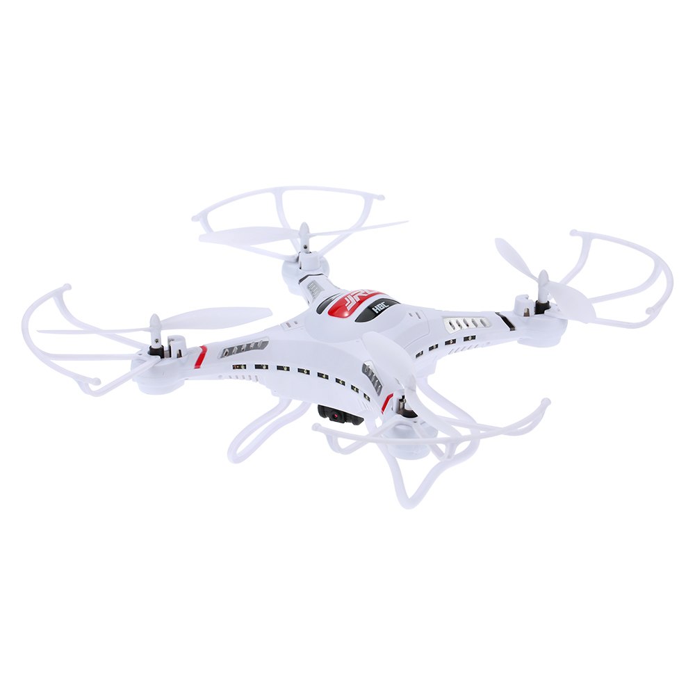

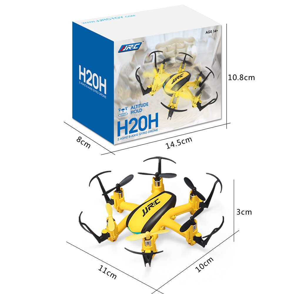

With USB connection, FPVFreerider worked with WINDOWS 10 64bit without problems.
Others own H8-MINI,JJRC H8C、H8S-3D H20H、H98, X400, X600, X800, SYMA X5C-1
but confirmation 22 It will be a day.
H8C and H20H do not bind in [20190204 deviation-t8sg_v2_plus-v5.0.0-848faf5].

H20H is supposed to use the H8-3D protocol with H20H format selected in protocol options. That's a 1 Mbps protocol, there's no reason it doesn't work except if they've changed the protocol.
I'm not sure the H8C is supported yet, it's not on my compatibility list (only H8C mini, not the same ...). Do you have a logic analyzer ?
Replied by goebish on topic protocol for WL Heli V911-s
demonogura wrote: H8C and H20H do not bind in [20190204 deviation-t8sg_v2_plus-v5.0.0-848faf5].

Good evening, goebish.
Thank you for the advice of H20H.
I will try to bind test.
I also understood the case of H8C.
Unfortunately, I do not own the logic analyzer.
Thank you very much.
