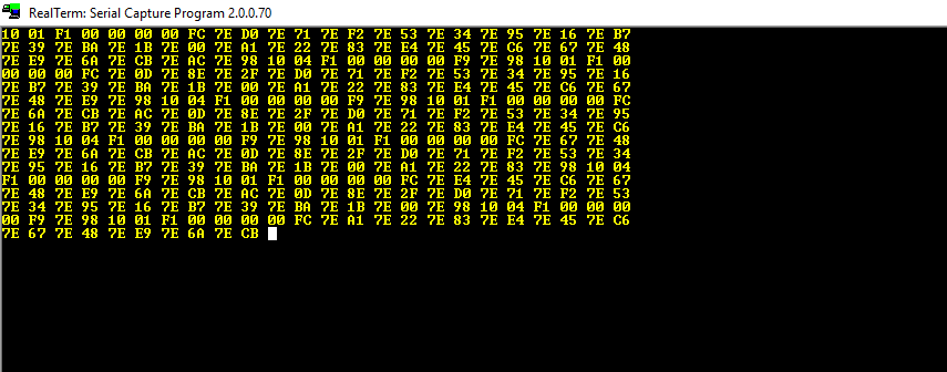

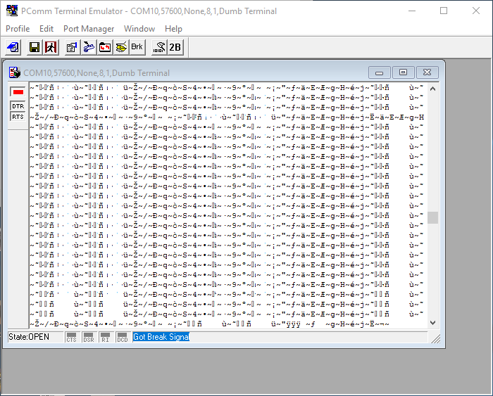

Hmm difficult to see, inverted or uninverted both looks like rubbish, although inverted probably better....
The data displayed is FTDI programmed to inverted
Last edit: 09 Dec 2018 20:33 by Fernandez.

The second capture with hex display (the one with many "7E" values) looks promising. Was that captured with data normal or inverted?
Whichever it was, please capture again with the receiver bound and powered on. May make a difference in the output data. Please save the data to a file and post that as it will be easier to check for valid data.

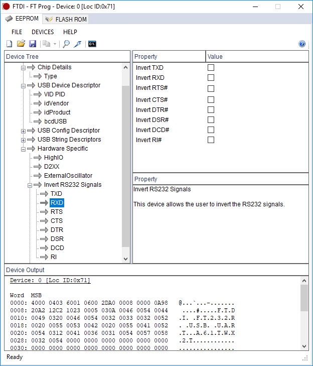

Ah I am crazy,certainly this S-port is inverted as I programed flashed my R9M via Sport and used the same usb programmer tool as for the receivers...…
So I have to make a little mosfet inverter or can we invert the UART Rxline same as on F3 flight controller?
Last edit: 09 Dec 2018 21:53 by Fernandez.

Unfortunately the processor can't invert the signal. You'll need to make an inverter for now. I might look at a soft serial implementation but not sure it could support the data rate.

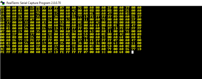

10 Dec 2018 05:20 #72036 by hexfet
Replied by hexfet on topic PXX protocol
Test build is updated (fe73771). Fixes for s.port telemetry.
Thanks for the data capture - very helpful. It has RSSI and Battery telemetry values in it. Is it correct that the second capture (with many 7E values) was made with inverted data settings on the FTDI? If so that means an inverter will be needed for deviation, at least for now.

Thanks Hexfet, I confirm the txt file recorded in last post was with the FTDI setting to inverted.
