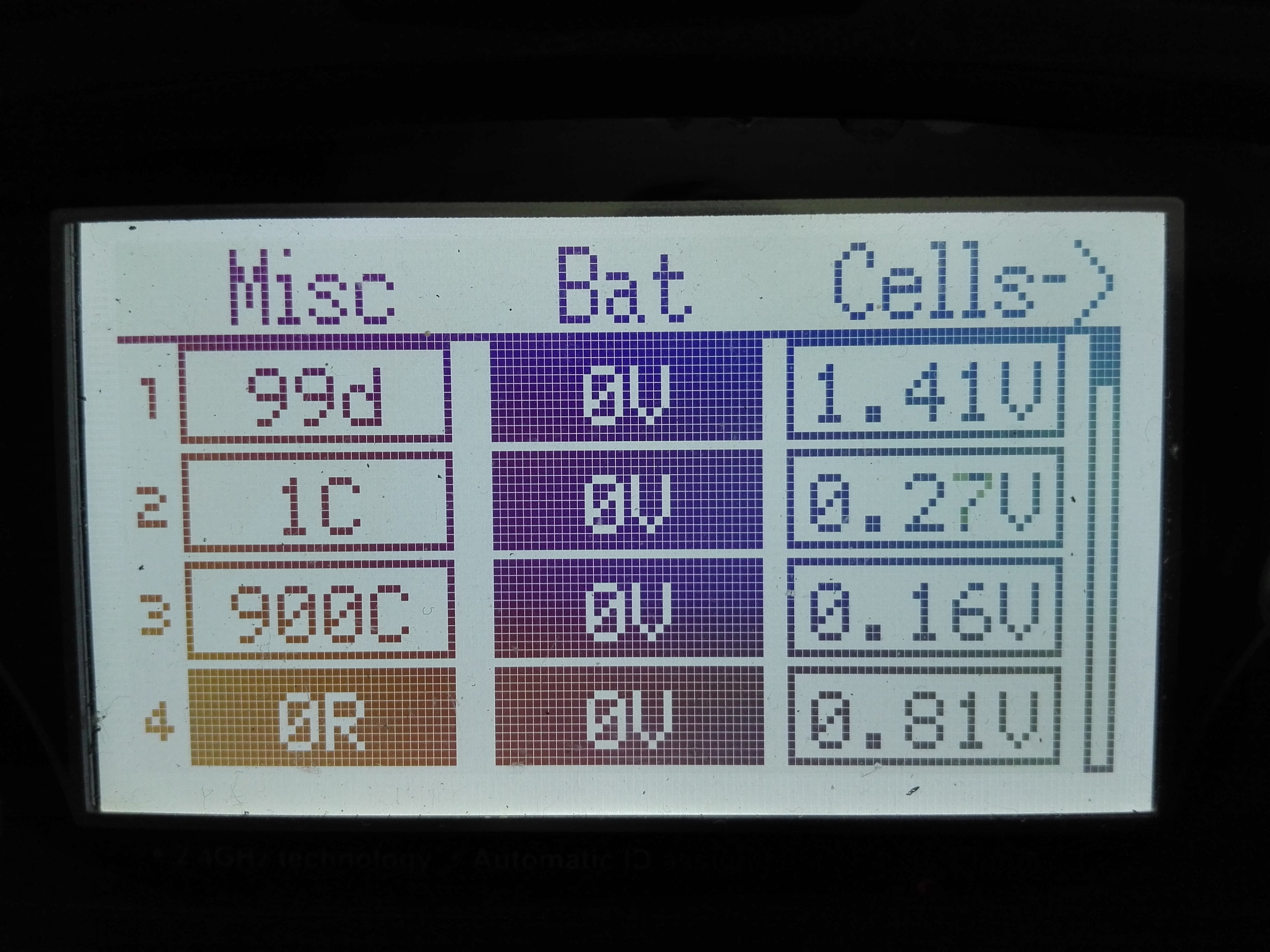

21 Mar 2019 00:15 #73458 by joeclone
Replied by joeclone on topic PXX protocol
hexfet wrote:
For testing I've added a test build(93d878b) to map these sensors to the following display spots:
ALLCELL - APID_CUST_RSSI
CELL1 - APID_RX_RSSI_REG_VAL
CELL2 - APID_RX_SNR_REG_VAL
CELL3 - APID_RX_PACKET_LOST_VAL
CELL4 - APID_MAV_BASE_MODE
CELL5 - APID_MAV_SYS_STATUS
CELL6 - APID_MAV_CUSTOM_MODE
Ignore any decimal point that may be in the display for these items. In the captured data only CELL1, 2, and 3 are non-zero.
From test build 93d878b, values on cell row 1 and 2 and always fluctuating and 3rd row value is constant. Other values remain the same.
21 Mar 2019 17:02 #73474 by hexfet
Replied by hexfet on topic PXX protocol
Thanks again. All four captures show the issue with occasional missing bytes. The data is coming out of the Qlrs that way - it's not an issue with deviation missing bytes.
Running these captures in the emulator the altitude is always displayed as 0. I'll try running sending to a devo to see if big number shows up.
Not sure what to do about Qlrs sending non-standard sensor IDs. For RSSI the value can share the existing RSSI spot except Qlrs is also sending the standard RSSI sensor ID with value 1. If SNR is the only other value of interest I can find a spot for it. The captures include GPS altitude and speed information that's always 0. Are they reported correctly if the GPS is locked?

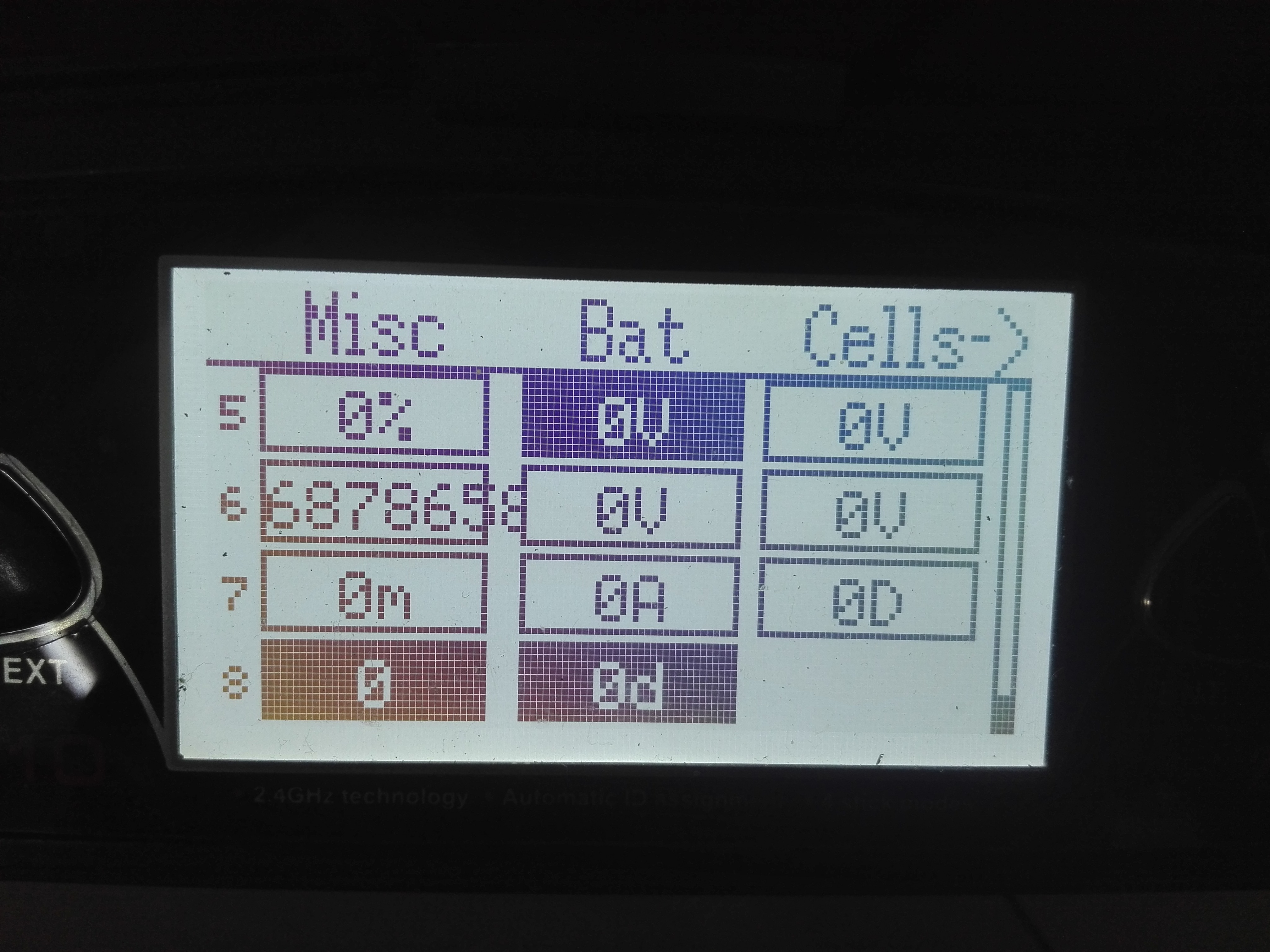

21 Mar 2019 22:23 #73491 by joeclone
I'm still bench testing so don't have gps connected, so is right there's no gps data. Do you know what place holder is the value 6878658 for? I'm trying to get in contact with the qlrs dev to hopefully get some answers, anyway thanks again for spending time on this.
22 Mar 2019 00:32 #73501 by hexfet
With the latest test build (93d878b6) on my devo10 and sending in any of the capture files the only altitude value displayed is 0. Very strange that your tx displays the 687 value. Was that on the display while making the captures? Maybe try a full install including filesystem, create a fresh model file, and see if the behavior changes.

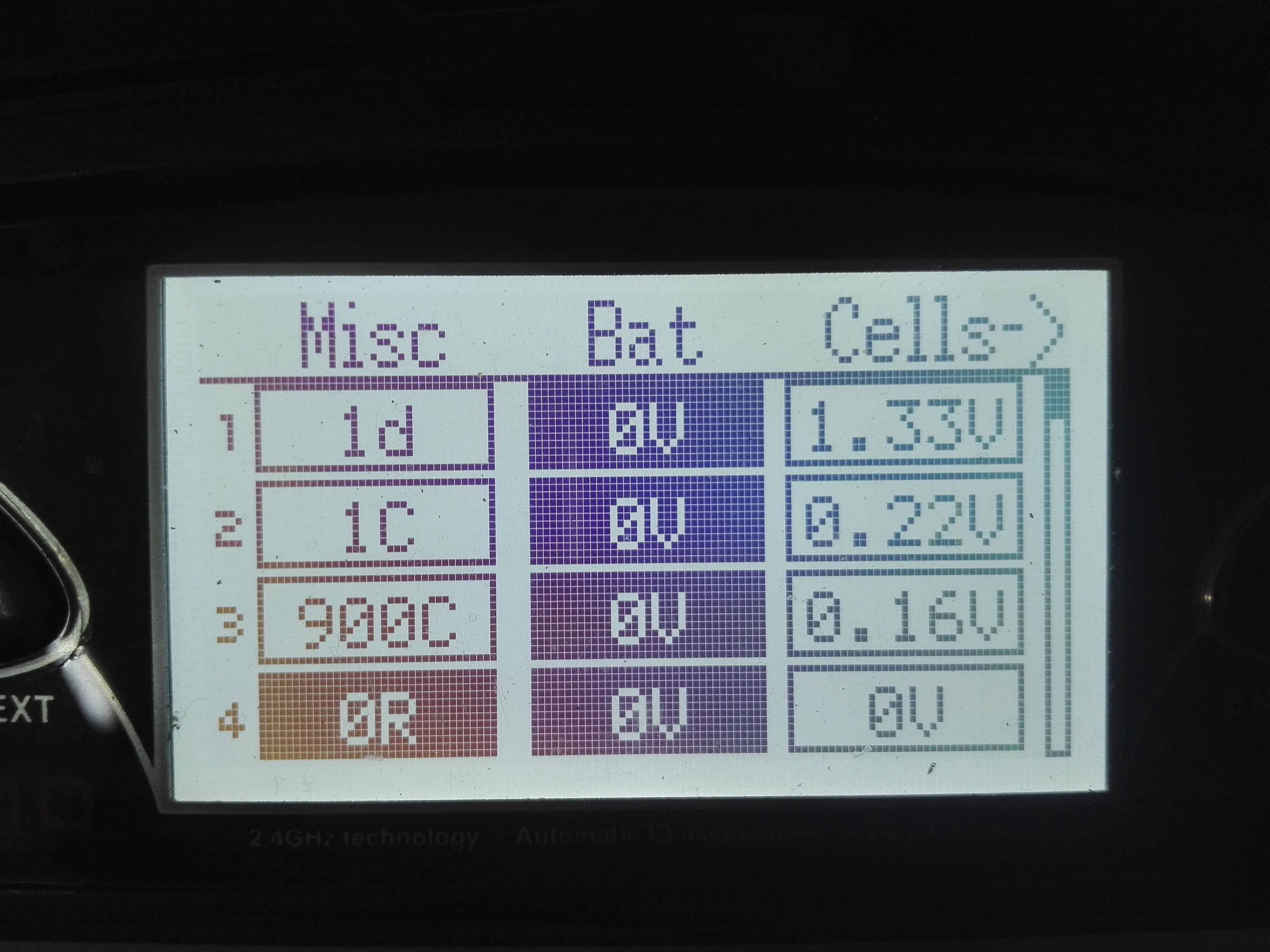

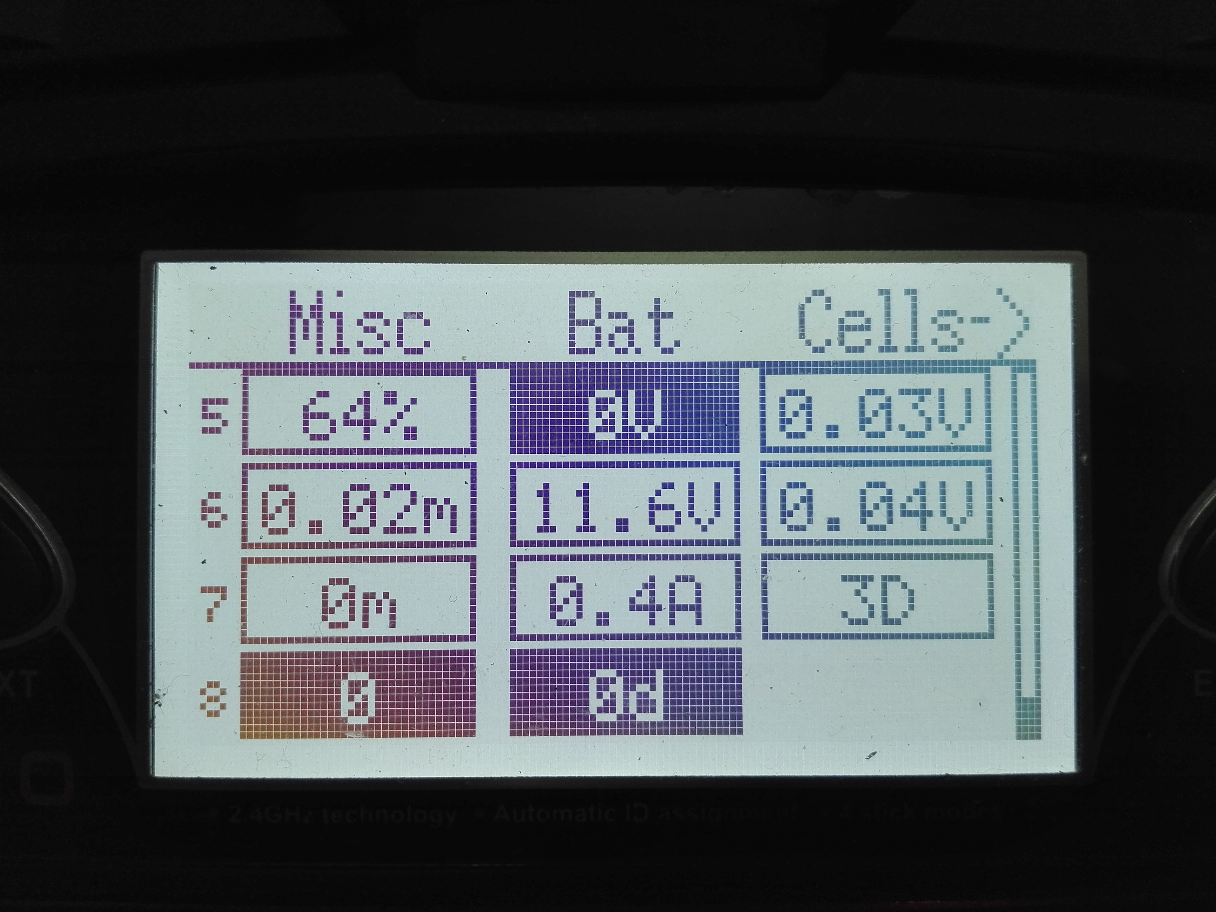

29 Mar 2019 13:25 #73599 by joeclone
Finally got the telemetry stuff worked out at the fc >> Qlrs rx >> Qlrs tx >> Devo. I'm currently getting telemetry info on the Devo screen and as you adviced I copied a fresh filesystem and tested with a new model file. What is the value at last row of Cells column? It's with a unit of D and this value is slowly increasing.
29 Mar 2019 14:29 #73601 by hexfet
The box shows Discharge in mAh.
Are the pictures from the test build or a regular nightly? The test build puts the Qlrs custom sensors in the Cells column. Do we need to find a permanent place for some of those values?
