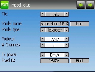

To bind, plug in the battery and when it's flashing fast, you can press the bind button in the Devo8. (Tap the model to get to model config, then go right one page. You'll see the protocol etc, at the bottom is the bind id and button.

Okay cool. I'm almost home, so I'll try that. Just one more thing - do I need to erase the code that is in there before I bind?

Holy crap! It freakin' worked!
