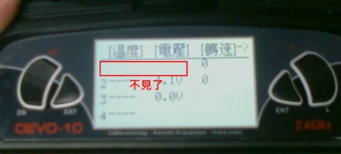

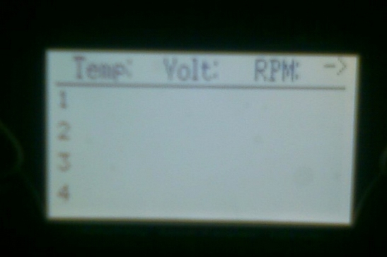

I got a report than when a minicp is bound with devo10, the telem monitor page becomes empty.
When I repeated the test, I found that the telem design is even worse:
1) Set both devo10 TX and minicp to no fixed-id. Then turn off both
2) Turn on the devo10 tx and wait till if finishes auto-binding
3) Turn on the minicp, even thought no binding is in progress, the minicp will still be bound to the tx
4) Check the telem monitor GUI, all widgets,except the title, disappear

The reason that the telem page is empty is due to redrawing too many widgets in the 100ms page_event. After I slow it down to 2seconds period, it becomes normal.

I finally figure out the true reason: the NORMALBOX_FONT and NORMALBOXNEG_FONT are not set hence not supported in devo10. My question is : why do we need to care TELEM_ERROR_TIME?

It appears we need to release a new dfu for the DEVO10 to fix this properly, but a work-around should be to add this to the config.ini file:
[font-normalbox]
  font=5x7
  font_color=FFFFFF
  bg_color=0
[font-normalboxneg]
  font=5x7
  font_color=FFFFFF
  bg_color=0
You'll lose the box, and can't distinguish the missing data, but it should at least provide data.
