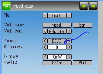

Thank you, but I have devo 6, the file attached seems to be for devo 8.suvsuv wrote: Try upgrade with attached dfu, it should work.
Note that in this latest version, telemetry is turned off by default, you need to turn it on in the model setup page by pressing the Devo button
