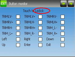

Is this a bug? Can't see a change in button FW2.0 was created by deewee8

Yes, the string is not completely replaced when locking and unlocking the screen.
However, when I press a button the indicator turns red as it should and the lock does stop the screen from changing when pressing left or right.
03 Dec 2012 14:27 #3564
Replied by PhracturedBlue on topic Is this a bug? Can't see a change in button FW2.0
I've checked in a fix for this.
