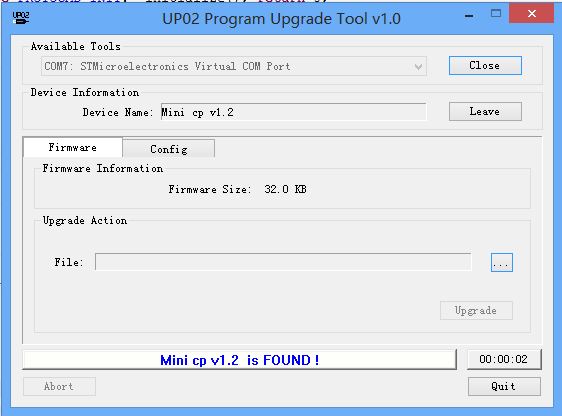

I think that version, shown on the upgrade tool is the hardware version, not the fw!
That's why it won't change after the fw upgrade...

FDR wrote:
That shouldn't be hardware version. The RX board I received back is exactly the one I sent it to Walkera, simply because I can recognize solder bumps that I make to connect a BLHeli ESC to MOSFET pin and VCC/GND in the RX.

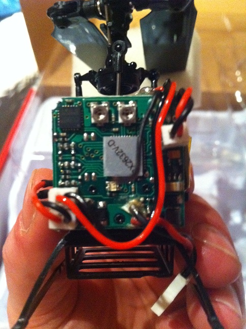

which RX do you have, the one with on potentiometer, or the new with two see that photo:

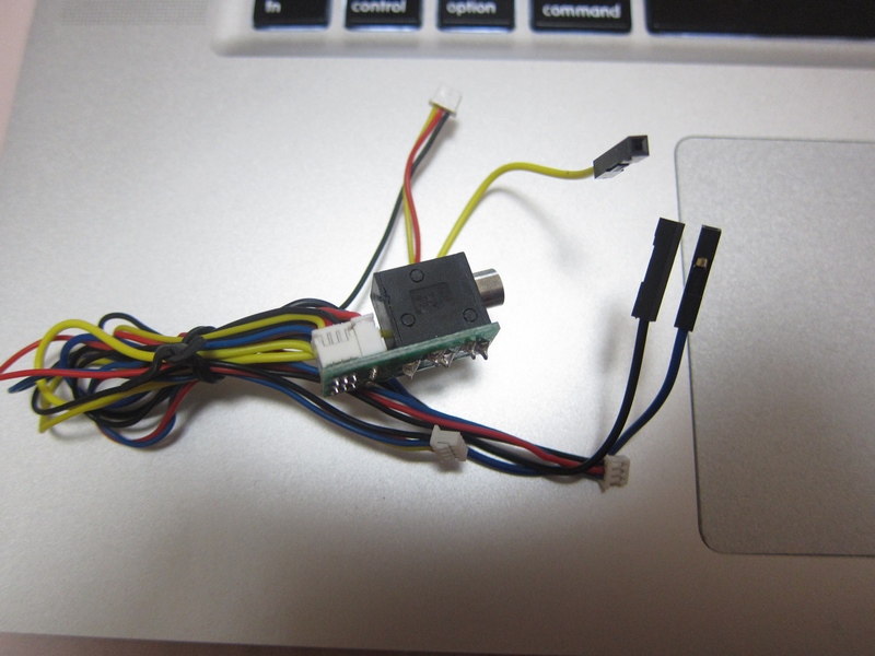

PhracturedBlue wrote: suvsuv. I assume you have the UP-02 adapter to convert the phono-plug to the right connector for the MiniCP?
Can you take a voltmeter and see if it is just a map from one of the phono-pins to one of the micro pins? And if so, which pins are connected? I am going to try to see if i can get my CP2102 to work as a UP02, but I don't know which pin is receive/send/ground on the Rx even though I know the answer for the Tx.
Yes, I have the UP02 adaptor. But I am on a trip currently, and will get the pin information for you after I back home during the weekend.

I was stuck in binding with Fixed-id yesterday so I don't test its flight behavior yet. But it was very stable in the past. My RX is the old version with on potentiometer.

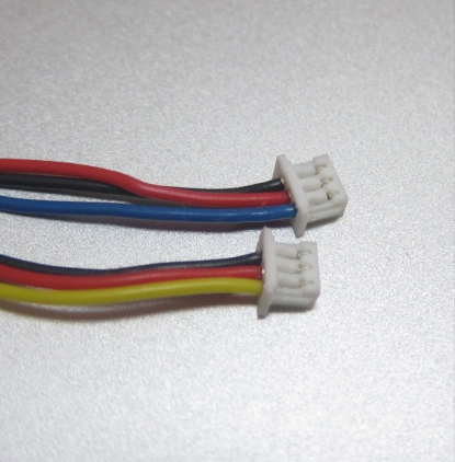

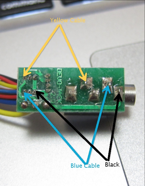

Please check out the images for pins info., The 2 red pins are not used
