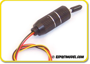

Honestly lots of things I'd like little different on TX but i'd rather leave throttle hold standard/stock. When club flying you may ask for help and they may well say no when stuff like that are different. After all if you learn nothing but where throttle hold is can save a lot of time in repairs.
Why not change switch for momentary on switch and just let go when needed? Devo don't trainer switch(other name for it) or software as yet but be handy to have.
www.espritmodel.com/transmitter-accessories-jeti.aspx switchs
