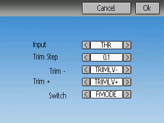

I'ms sorry slightly old topic...
By my language barrier, I can't understand how many "flight-modes" can I make.
I saw source codes and found descriptions "FMOD0 FMOD1 DMOD2".
Do there mean only 3 indipendent trim sets (=flight modes) can be make?
Or over 5 modes? I'm a sailplane flyer so I need 4 or 5 flight-modes.

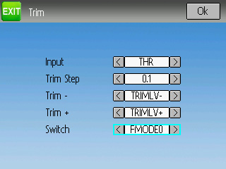

Just checked it with emulator, it works for nightly builds with "FMODE0" switch, but it's confusing. With "FMODE1" it has 2 trims only, with "FMODE2" it has 1 trim only.
I don't think it is normal behaviour.
It's related to next commit:
github.com/DeviationTX/deviation/commit/...c0a3ec01d4a28a7f9d6d
I don't know what is #600 issue.
Last edit: 29 Jan 2018 07:15 by vlad_vy.

Replied by vlad_vy on topic Independent trims for flight modes
I don't see any sense in #600 fix. The trims "Switch" field is intended to enable multiple trim positions for Flight modes. So, it was intentional choice for "FMODE" format, without position indicator.
www.deviationtx.com/forum/3-feedback-que...modes?start=20#10763
I think will be better to return it back.
Last edit: 29 Jan 2018 09:03 by vlad_vy.

At any case, we can't have >3 flight modes independent trims. Even if we will use spare trims, we have only 2-6 spare trims.

Fixed, now it works. Forget to save and read 3 additional trims positions.
Hayataro, work in progress. Right now you can use 3 independent trims set, assign to trim "Switch" (at trim properties) any 3-pos switch, position 0, for example "FMODE0".
After fix will be applied you can use "FMODE" for 3 trims set. With next fix you can use 4-6 contiguous virtual channels to setup 4-6 pos switch, assign to trims "Switch" first virtual channel and you will have 4-6 trims set.
Right now I testing 6-pos virtual channels switch (it use GEAR and FMODE switches) and 6 independent trims set. The virtual channels switch at any state should have only single channel with +100% value, all others -100%.
