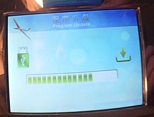

then I like to do a backup from my settings. but if I connect the devo to my PC and power on with EXT pressed I get the wrong screen (see attachment jpg file)! no USB sign! and no drive on windows7.

have you tried holding the ENT button while power up to see what happens?
you can also get to USB mode in the software on the usb page it should say "turn on usb mode"

hello magic_marty.
Thanks for your help! problem solved!!!
in the usb setup page I have to push the ENT buttom to get in the usb mode! then I got the drive that was missing!
thanks for your quik response!
now I can make bakups and share my settings here.

holding ENT while power up works good too!!!
