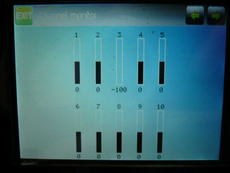

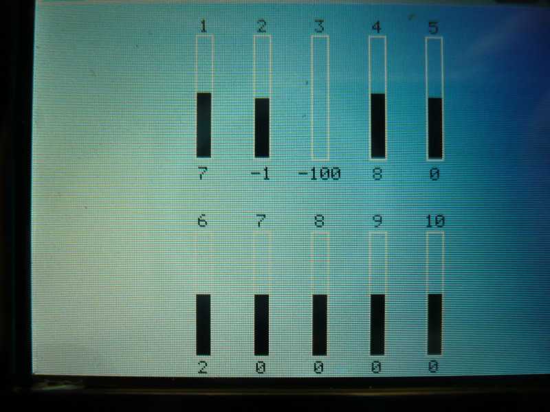

me again with an annoying little bug I can't find a solution to.
My devo 8s is repeatedly decalibrating the center values of all Stick input. If I calibrate the sticks all center values are put to zero. But if I then switch off and turn the TX on again, the center values of all cyclic channels incl. collective pitch are not equal to zero anymore.
See pictures
ee pictures attached.
Having used FW vers. 2.10 I have already upgraded to v. 2.11 meanwhile - with no changes at all.
Am I the only one with such a problem or does anyone know what I am doing wrong here or what I could do to not have to recalibrate each time I turn on my TX

04 Feb 2013 09:43 #5988
Replied by FDR on topic Need to calibrate sticks each time I turn on TX
It seems, that the fw can't save to the "tx.ini".
(You can try to change something in the tx menu, like language, brightness, bat. alarm, etc, and look if it is saved on powering off.)
Make sure the tx.ini is there, valid, and not readonly.
If it doesn't help, delete the tx.ini, and copy a new one from the filesystem zip file.

05 Feb 2013 10:43 #6046
by digitracer
Replied by digitracer on topic Need to calibrate sticks each time I turn on TX
Hi PB,
thanks so much for responding.
The TX.ini asked for you can see in my post above. This was copied after I had changed Language setting (which was put to German and obviously been saved) and where sticks had been centered (but here values did not change to previous version of TX.ini). So obviously my installation of 2.10 and 2.11 are neither reading the calibration values (since they do not even react to manual changes of the zero values) nor do they write values to the TX.ini.
My battery voltage is currently at 4.97V (must have been even higher at that time).
