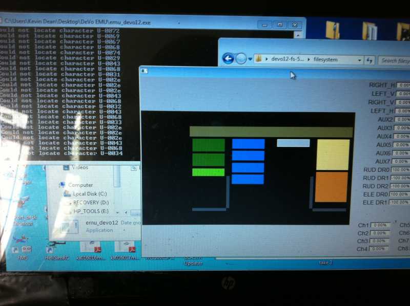

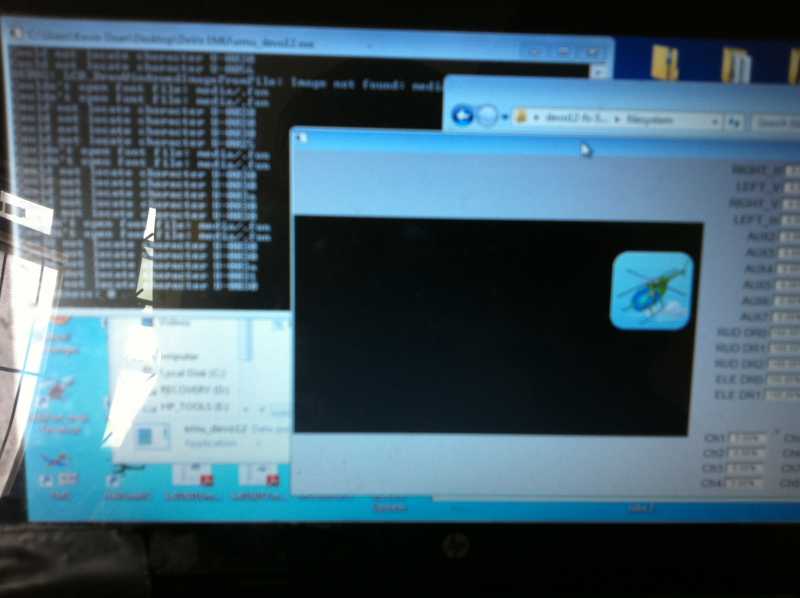

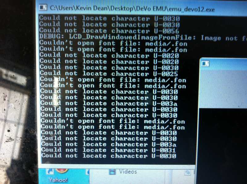

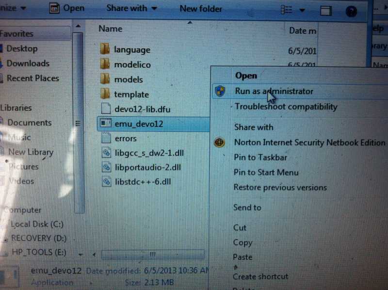

I put the three dll files in the folder with the emu and tried many combinations of devo file systems, but all i get is a black screen and the data stream screen showing it cant locate alot of stuff. At one point i would get the model icon and a layout screen, but the back ground remains black and i can only shift from box to box with the arrow keys.
I also use "run as admin" but same results.
What im i doing wrong?

06 Jun 2013 22:31 #10658
by Kdean
Replied by Kdean on topic Need EMU How To Use
Here are some images
