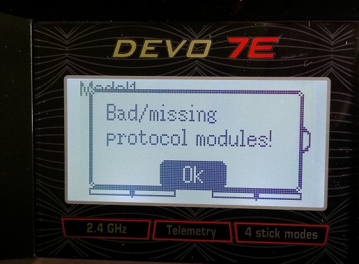

I just try the firmware from
www.deviationtx.com/forum/7-development/1230-devo7e-work
, it still not work.

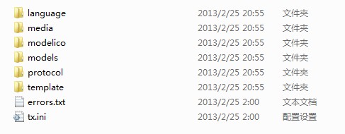

my resource file to the TX-DISK is from D10 like this:

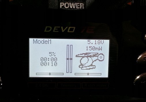

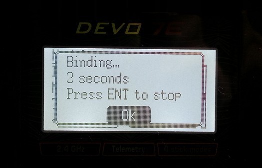

The main page is:
The model set and bind interface:

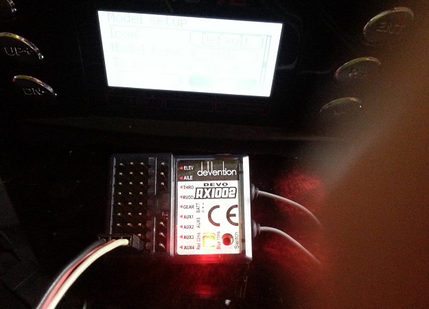

My rx is:
The main page is:
My rx is:

Replied by vlad_vy on topic Why deviation-devo7e-b1b5bcecde6b.zip doesn't work
Do you use 'protocol' folder from the same .zip file (build)? File .dfu and 'protocol' folder have to be from the same build.
Last edit: 25 Feb 2013 15:32 by vlad_vy.
- Xermalk
- Posts: 181
25 Feb 2013 15:35 #7034
by Xermalk
Replied by Xermalk on topic Why deviation-devo7e-b1b5bcecde6b.zip doesn't work
Theres a check implemented now so if the wrong protocol files are used you get a warning.vlad_vy wrote: Do you use 'protocol' folder from the same .zip file (build)? File .dfu and 'protocol' folder have to be from the same build.

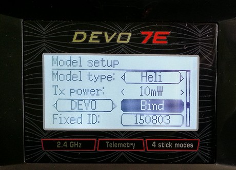

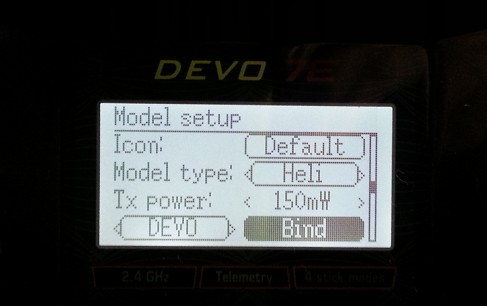

I have try and confirm the problem is just like you say!
when I set a FIXED-ID, it can not bind with RX anyway:

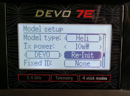

Then I clear the FIXD-ID, the caption of BIND button changed to 'Re-Init', when pressed, RX bind OK and work well~
I have also try AUTO-BIND on boot, it work well too.
So the problem seems to be a little BUG of FIXED-ID.

re: domcars0
no, I just plug the shorter and poweron RX, when RX LED flash slowly (indicate ID in RX is cleared), I have removed the shorter (BIND Plug), then turn on TX to operate...
In a word, in my test, every time I want to make a binding, a clear operate is always be done in RX, and "NONE-ID" is ok but "FIXED-ID" will fail.
