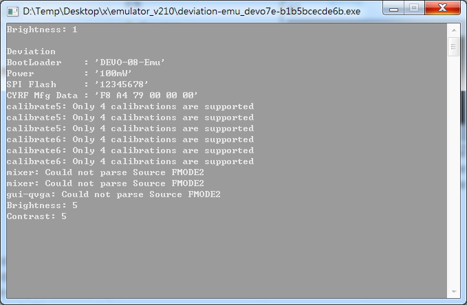

Replied by vlad_vy on topic DEVO 7E emu problem - need help
Seems the emulator has known bug Devo 7E, it cann't parse 3-position switch (FMODE2).
bitbucket.org/PhracturedBlue/deviation/i...rd-mixer-invalid-ini

01 Mar 2013 05:31 - 01 Mar 2013 05:31 #7184
by dc59
Is that mean DEVO7E emu program can't be used at this moment?
Thanks.
Replied by dc59 on topic DEVO 7E emu problem - need help
vlad_vy wrote: Seems the emulator has known bug Devo 7E, it cann't parse 3-position switch (FMODE2).
Thanks.
