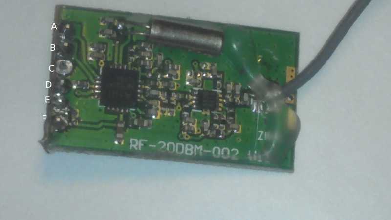

As far as I can tell, any transmitter that can bind a v911 can bind a v939 and vice versa, but the v939 Tx module doesn't look like the one in the v911 Tx. Given that I have 3 v939 tx's and one v911 one, I'd much rather sacrifice the v939 Tx. So...
Anyone know if this will or won't work already?
If not, then the attached image is of the top side of the module. The labels on the pins (from the board the module came off of)
A: 3.3V, B: GND, C: GPIO, D: SDIO, E: SCK, F: SCS
While you can't make it out on the photo, the chip on the board is labelled (as best I can make out)
A7105
AMP33047
1219G
Given that information, can anyone tell if this module could be used in lieue of the the v911 module? Or that it can't? Or that it might be?
Anyone willing to try making it work if I mail them the module?
03 Mar 2013 13:27 #7284 by PhracturedBlue
Replied by PhracturedBlue on topic V939 Module for FlySky/Huban/etc. protocols?
While I haven't done it myself, it should work just fine.
You need to hookup all pins except gpio. Make sure you get the order right.
03 Mar 2013 17:23 #7292 by blackmoon
Replied by blackmoon on topic V939 Module for FlySky/Huban/etc. protocols?
Yesterday, I installed the module from V929 TX.
It is like yours, works like a charm.
You'll feel all your mini quads different, more connected :D
Be careful when soldering there isn't much place on the devo module header.
Use the finest tip you have, mine is "quite large" and I shorted 2 pins in the process, needles to say it was a pain to remove.

I have been using v939 tx module in DEVO 10 for a while and it seems to be working just fine.
And as far I can tell, the tx module seems to be identical (at least for the part number) in both remotes (the remotes are quite different). Though they could have changed the design later.
mwm wrote: As far as I can tell, any transmitter that can bind a v911 can bind a v939 and vice versa, but the v939 Tx module doesn't look like the one in the v911 Tx. Given that I have 3 v939 tx's and one v911 one, I'd much rather sacrifice the v939 Tx. So...
A7105
AMP33047
1219G
