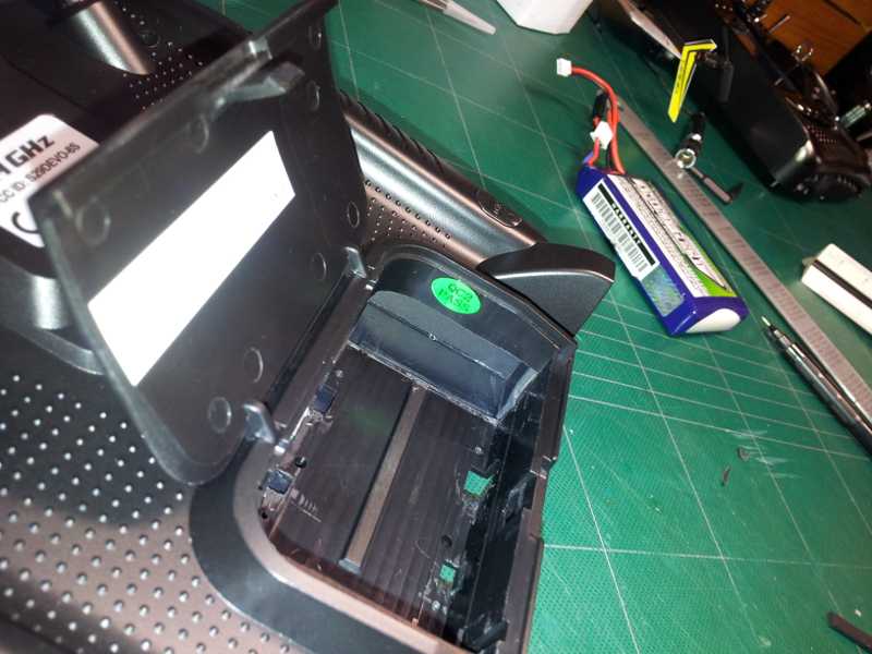

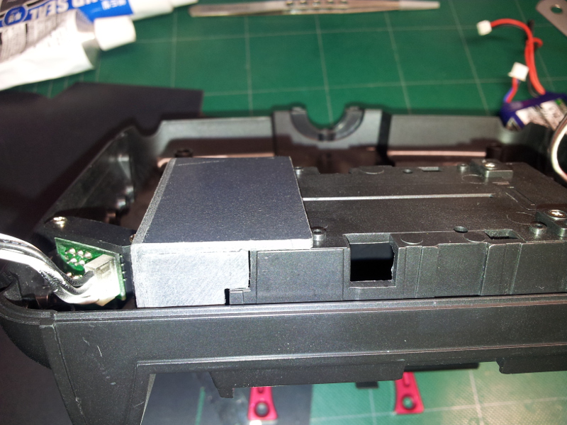

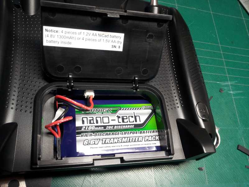

Hmm, looks strange. Can it be a contacting problem? The lcd (with touch surface) has its own board and a multi pin header to the main board...
I don't believe that the voltage was too low before because many of us run with NiMH / NiCD and similar without problems. Maybe a bad regulator?
