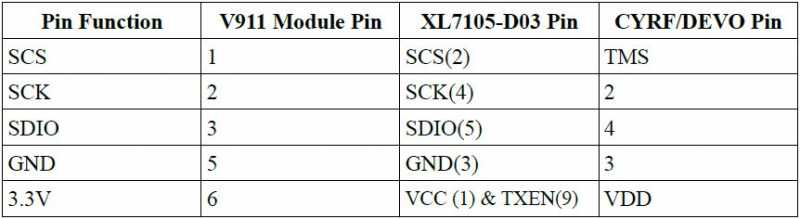

PB, I've got an issue when putting in the V911 board.. All the leads were soldered and are clean, but when I power on the unit, the light blinks on for a second and then goes out. No sound, no boot.
When I desolder the VDD lead from the PCB or Pin 5 on the V911 module however, I can turn it on just fine.
Any thoughts?
Any thoughts?
27 Mar 2013 15:06 - 27 Mar 2013 15:10 #8149
Replied by vlad_vy on topic Multiple Modules?
Last edit: 27 Mar 2013 15:10 by vlad_vy.

Ah.. Yeah. I thought it was the CC2500 pins that were flawed.. The above isn't the same as the instructions.
I'll redo the connections again later. Right now I pulled the whole thing to ensure it would still work, which it does.. Had an issue of the power cycling even with the pin 5 disconnected, so I thought it was frying.
All good. Thanks for the correct pinout!

27 Mar 2013 15:49 #8152
by DarkWolf
Replied by DarkWolf on topic Multiple Modules?
That worked perfectly, vlad. Resoldered the leads and tested with the module hanging out the side of the TX. Bound and good. Had to reverse all but the throttle on the 911, but it's flying fine. Will have to muck with the settings later.
Thanks!
