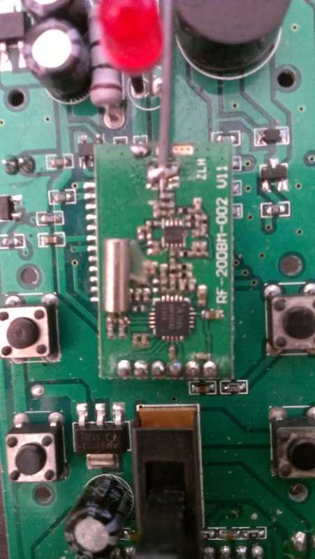

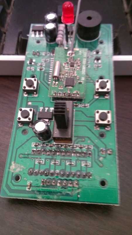

I have a DH9116. It uses the same board as V911. I installed the board into my Devo 10 thinking that I could use it to fly my DH. The only response I could get out of the DH is the motor would turn then it would cut out like it lost bind or something. I played with every setting/switch I could think of and finally came to the assumption that it could not be done (by me atleast, I am no expert in Deviation). Good Luck, I hope you get it working. My bro-in-law put a Walkera RX in his DH and it flies perfect with Devo 10 Deviation. Worst case you could replace your RX. I didn't want to drop anymore cash into my DH. It was a great trainer for me. I retired it and moved onto to another. (6CH). Hate I couldn't be of more help, but if you do get it working please post about it.
- DarkWolf
- Posts: 70
01 Apr 2013 17:33 #8375
by DarkWolf
Replied by DarkWolf on topic Double Horse
You're right. I was just about to post up the pictures from it (which I shall now do anyway)..
PB, I may have a spare RX board in this pile of parts (got a huge grab bag auction cheap.. 2 working heli, 1 blade 120sr parts, a v911 and crap tons of parts).. If I do, you want it to mess with?
